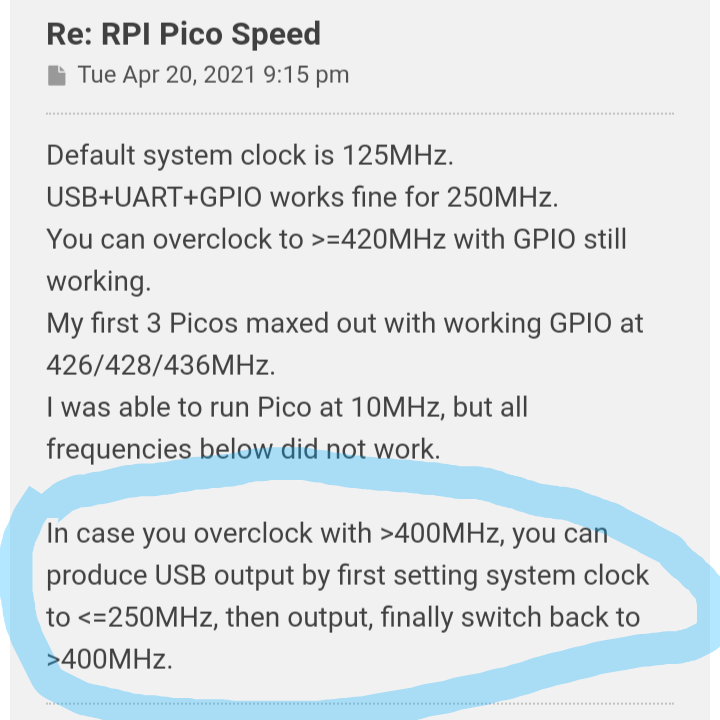

Anyone make any sense of the USB bit?
Craig
Posts: 11512
Posted: 04:03pm 05 Jun 2022
Says he is changing clock speed every time he want to use USB - pretty stupid IMHO
Tinine
Joined: 30/03/2016
Posts: 1646
Posted: 07:50pm 05 Jun 2022
But if we don't care about USB and we redirect the console to a COM port?
