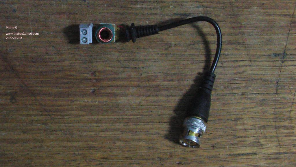

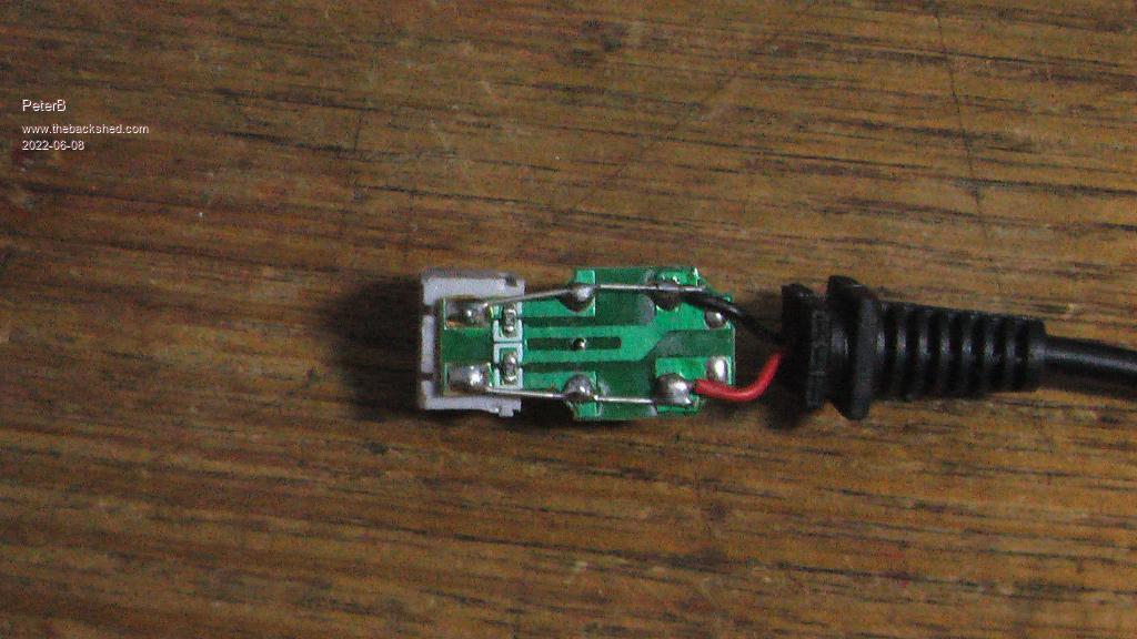

G'Day All
We have a CCTV system that has worked for some years but recently started displaying horizontal lines on one camera.
The 5 lines were caused by 50Hz interference.
After a process of elimination, it was this BALUN.
So how did it happen?
All I can think is that it was a factory reject, repaired by by-passing the transformer and sealed up. And so it worked for years until
one of the windings went OC and acted as an antenna or black magic does exist or ?????
I am also a bit concerned that there is probably another 11 still in the system.
A week later one of the 12V coaxial connectors went OC but on a different camera.
Peter(B)

The balun bypass is a sick joke, tbh.

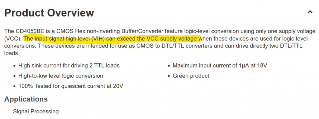

My Qty:100 CD4050BE shipment arrived today.
I did some random sampling and this is clearly a failed production batch.
Of the 6 channels, channel #2 is dead on every sample I tested.
I'm cool with it though. As long as I know, I can live with 5 channels and I won't be using them in customer-products.
Compared them with my "real-McCoy" 74HC4050s which can take a straight 5V on any input and provide 3.28V on the output. These particular CD4050BEs...can't do that because there is some clamping-diode-or-other. Current limiting with a 330R on the 5V signal and all is good.

This is all I ever see BUT without a few hundred ohms to limit the current, they just shut down(!?!?!?)
I'll never get along with datasheets
Craig
Posts: 8911
Posted: 07:11am 15 Jun 2022
Found a data sheet. CD4049UB and CD4050B are identical except that CD4050B has an extra MOS pair on the output to convert it to non-inverting. The input circuit is the same, with protection diodes.
Yep - the diode to VCC is reversed so you can exceed VCC on the input.
The diode to gnd prevents the input from going negative. Then there is a series resistor (value unknown). You must limit input current to less than 10mA.
If you are having problems with them latching up it may be that VCC is too low or that there is too much input current.
