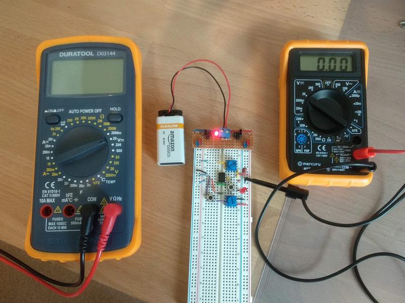

Hi folks,
This should really be in the "Electronics" forum but my experience is that because it is a beginner question and isn't about Inverters it will get ignored. Perhaps you will tolerate it here and someone can help me out.

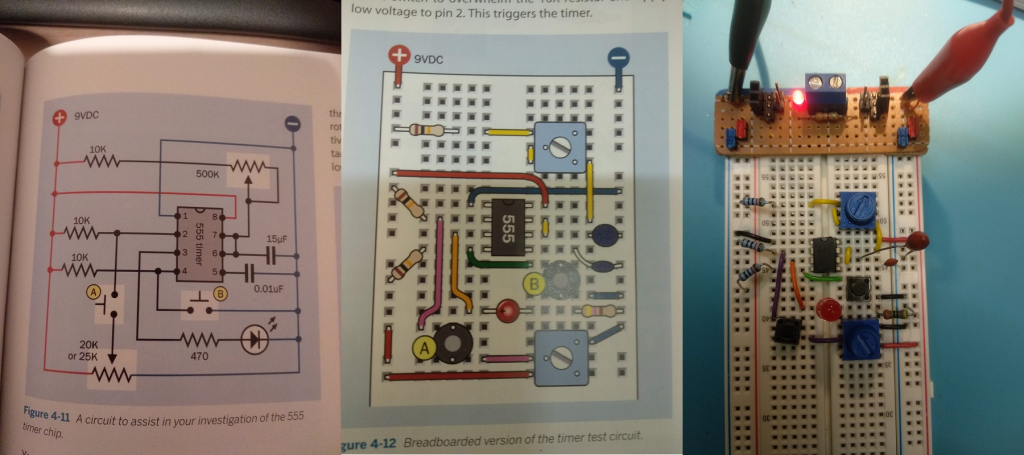

I'm playing with a 555 timer in monostable mode:
Note intentional differences between diagram and actual breadboard - I'm taking advantage of the fact my breadboard has two power buses to avoid some of the longer hookup wires.
It all seems to work as described except that one of the tests in my text book is "Get out your meter, set it to measure DC volts, and measure the voltage between pin 2 and negative ground while you adjust the 20K trimmer to various settings and press button A. I'm betting that when you press the button to a apply a voltage below 3 volts to pin  2, the timer will falsh the LED. Above 3 volts, I doubt that anything will happen."
What I'm finding is that connecting the probes to measure the voltage is triggering the LED pulse without button A being pressed.
Any ideas ?

Your 470ohm resistor appears ?? to be connected wrong - looks like the left end is one hole right of where it should be?  Picture not quite clear enough to be sure although this shouldn't make any difference.
Doug.
Edited 2022-06-24 10:24 by panky
lew247
Joined: 23/12/2015
Posts: 1709
Posted: 07:11am 24 Jun 2022
Your 470 ohm resistor is the wrong side of the LED
Swap them around
and make certain your led is the correct way around or it won't work the way you want it to

The location of the LED and the 470 ohm resistor appear to be reversed on the breadboard but apart from that the circuit looks correct to me. It's hard to tell but it looks like the flat (cathode) is on the right (negative) side going to the 470 ohm resistor which is connected to the negative supply.
Tom is seeing the circuit triggering so I am guessing that that part of the circuit is working.
Even if it were wrong, it would not affect the triggering.
Please refer to my post above.
Bill
Posts: 4398
Posted: 11:23am 24 Jun 2022
Hi folks,
See additional photos.
1. I have the meter set correctly (20V DC range) - famous last words.
2. Same behaviour with both my (digital) meters: Duratool D03144 and Mercury MTB01.
3. The resistors all read correctly and are making contact.
4. Behaviour is same whether 470R resistor is "before" or "after" the LED - should that even matter, doesn't it current limit either way? Note that the schematic and diagram in the book actually show it two different ways.
5. I do know how to wire up an LED ;-) though I have been known to serial blow them when testing them without remembering to add a current limiting resistor.
6. Voltage on pin 2 is "correct" and controlled by the 20K trim as expected.
EDIT: You also get a pulse if powering up after connecting the multimeter. And also a pulse when disconnecting the multimeter ... but that might be "bounce" I suppose caused by briefly breaking and then making contact whilst disconnecting.
Basically everything appears to work as expected except that connecting the multimeter (+ve to pin 2 and -ve to ground) causes a single immediate pulse which AFAIK means it is briefly sending pin 2 low, but not maintaining it low ?

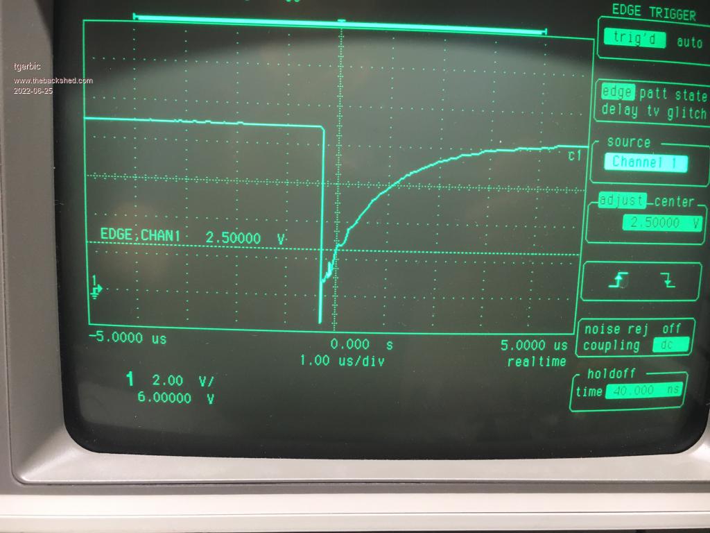

thwill, What book are you using?
I decided to build the circuit up and capture the traces, just for the fun of it.
Pin 5 shows the threshold voltage of 3V (VCC/3).
The upper trace is pin 3, which goes high when triggered, then low based on charge
time controlled by the 500K pot.
The second trace is pins 6 and 7 which shows the timer charging
The third trace shows the high pull-up being pulled down to <3V causing the triggering.
The fourth trace shows the trigger voltage set by the 20K pot being applied to pin 2 (when pushbutton is pressed) which pulls pin 2 down to <3V.
As expected as you vary the 20K trigger voltage above 3V and below 3V, the timer will trigger.
Now here is what I found interesting. I used my Fluke 45 DMM to measure the voltage at pin 2. Each time I touched the positive lead to pin 2 the circuit would trigger. Further investigation showed that this did not happen if I used a 10M resistor in place of the DMM, assuming the DMM presented 10M when it touched pin 2. Hmmmm...  I found if I used a resistor lower than 4.5K the circuit would trigger just like touching the DMM positive lead. However this cannot be it.
Next test was to try an analog meter. I tried using my Heathkit IM-25 and an HP 410C in place of the DMM and neither triggered the timer. Interesting that a digital meter would trigger the circuit but an analog meter would not. Perhaps this may be related to the auto range mechanism in the digital DMM or input capacitance?
Further examination of the signal on pin 2 shows when the DMM lead is touched to the pin the voltage can drop all the way to zero, and sometimes below??, for some pico seconds (below the trigger threshold for nearly a microsecond). Checking the schematic I can see a 100pf cap to ground in the middle of the DC volt path to the Analog Processor IC. I suspect that is causing it as I cannot see any other capacitive component in the path.
This is where the false triggering is coming from. Welcome to the fun world of hardware design and troubleshooting. Never completely trust your test equipment.
Yet another example of a difference between analog voltmeters and DMMs, or electronics theory and practice.
