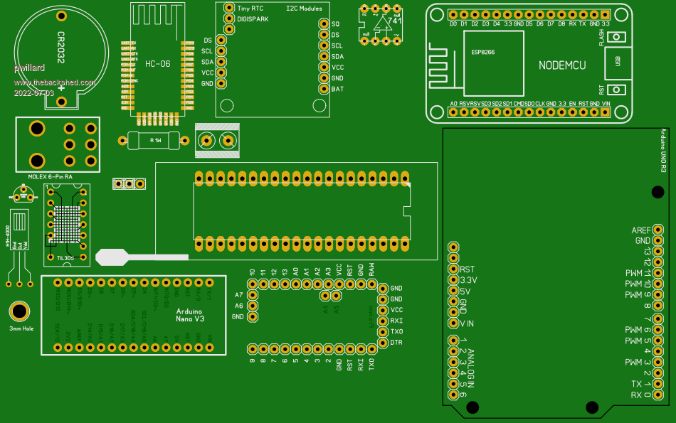

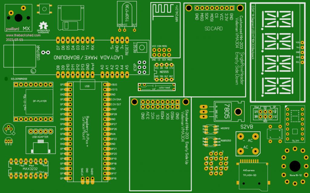

One of the things I use SprintLayout for is to make CHIP LABELS, like the way Grant Searle did.  This turns out to be very handy when breadboarding new designs.
I'll look through my Makros and see if I can find what is unique from the previous uploads to avoid duplicates.
ChipLabels.zip
