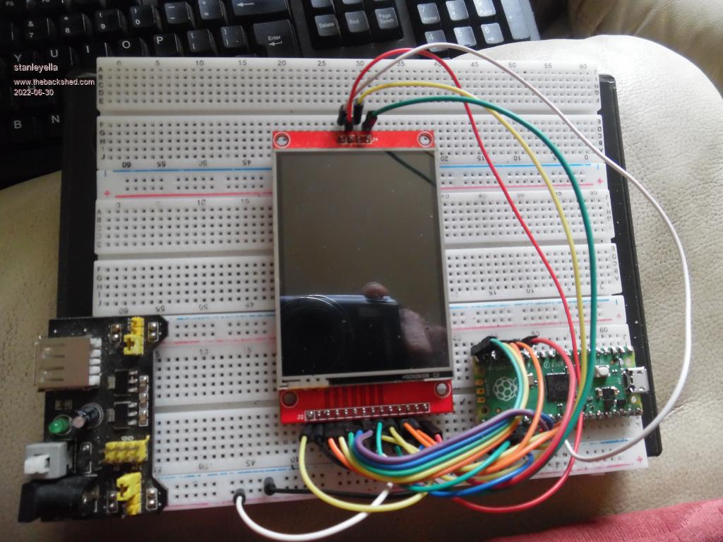

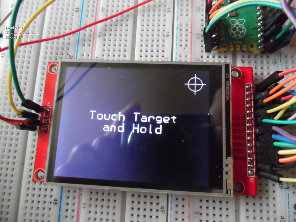

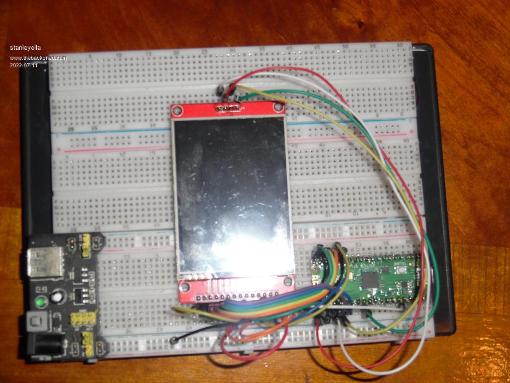

Hi. I just bought a rpi pico and have tried 4 ILI9341 glcds using picomiteV5,07.4.uf2.
The test lcd display displays coloured circles.
The gui calibrate either displays a target top left but touching it does nothing or on another display touching the first target draws another target top right and touching that print error touch hardware in the terminal.
Any issues with ili9341 touch screen?
cheers.

You have a wiring and/or OPTION issue - check the manual and follow details precisely.
One thought - does your display have the touch chip (XPT2046/TSC2046 - U1)

This because it is seeing the same coordinates for both. i.e. it isn't reading properly. Check that SDI(MOSI) is connected to T_DIN and SDO(MISO) to T_DO and SCK to T_CLK. Then all these should be connected as per the OPTION SYSTEM SPI command. If it responding to a touch then it is seeing T_IRQ but check T_IRQ and T_CS are specified correctly and the correct way round in OPTION TOUCH.
The ILI9341 code has been around forever and is completely reliable so it must be a wiring error
Make sure VCC is connected to 3.3V and not 5V

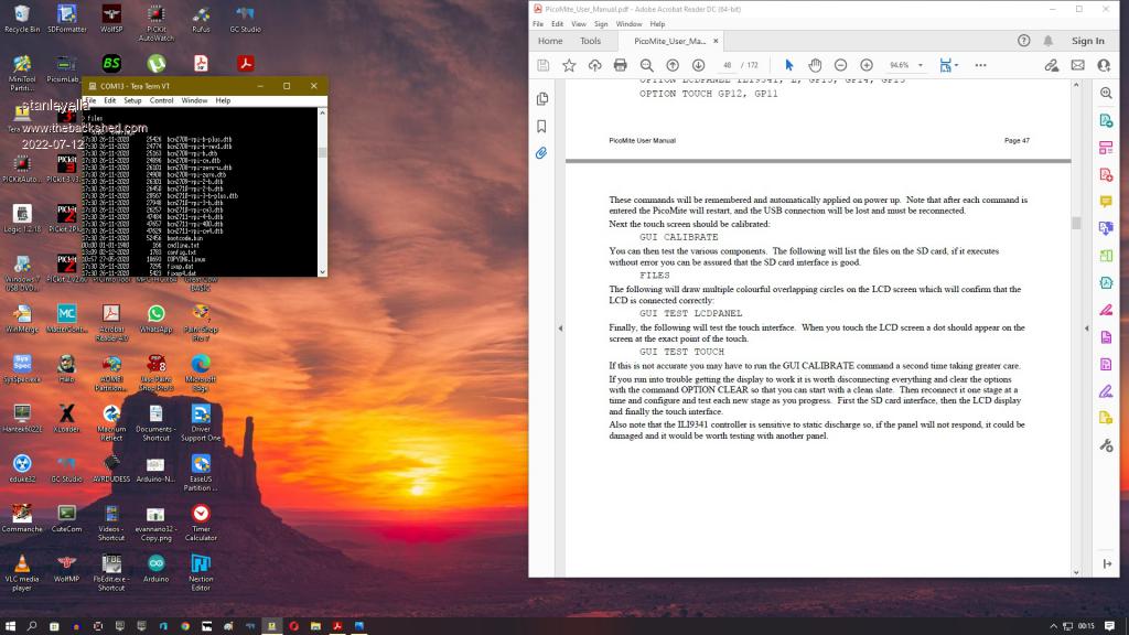

OPTION LCDPANEL ILI9341, LANDSCAPE,GP20,GP21,GP17
OPTION TOUCH GP14,GP15
OPTION SDCARD GP22
Please don't get discouraged. If you know the displays are working properly then there will be something simple that will reveal itself eventually.
It is worth building up slowly. Disconnect the touch chip and the SD. Then set a pixel on the display and read it back. If it reads OK then the two way SPI communication is working.
pixel 100,100
? hex$(pixel(100,100)) ' should give FCFCFC
if that works connect the touch pins as per my note above
  Quote  SDI(MOSI) is connected to T_DIN and SDO(MISO) to T_DO and SCK to T_CLK
Connect any free pin to T_CS and another the T_IRQ
Then configure touch "OPTION TOUCH cspin, irqpin"
