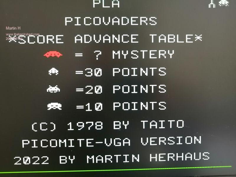

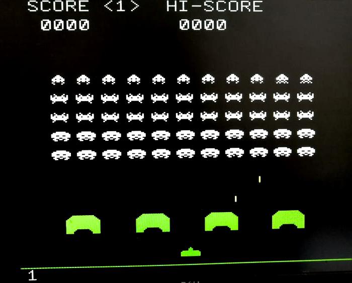

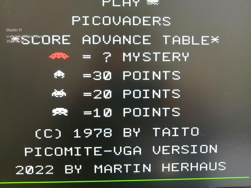

My first try of a complete Game in MM Basic on Picomite VGA
Use Cursor Keys to moce and Space to fire
If one would extend it by Joystick - Routines, you are very welcome
PicoVaders.zip
Chears, Martin

To the game....
Firing goes well. But moving the gun around is not. This is terribly slow.
I tried to increase the movement, but then the cleanup of old position of the gun is not correct.
Sub Move_Player
 k$=Inkey$
 If k$="" Then Exit Sub
 If Asc(k$)=130 Then plx=plx-3:If plx<16 Then plx=16:Exit Sub     'was plx=plx-1
 If Asc(k$)=131 Then plx=plx+3:If plx>188 Then plx=188:Exit Sub   'was plx=plx+1
 If k$=" " And BA=0 Then
   If Not ua% Then Inc Myst%,Int(Rnd*3)
   BA=1:BX=plx+7:BY=210
   For f=1000 To 1 Step -50:Play tone 1000+f,1000+f,5:Pause 2:Next f
 EndIf
End Sub

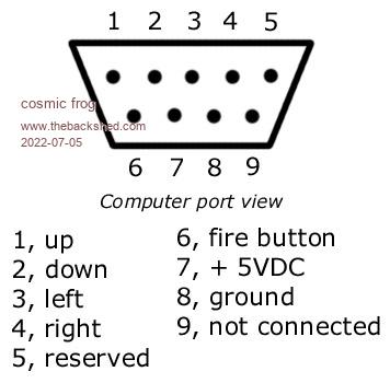

Atari joystick pinouts.
Posts: 4405
Posted: 10:02am 05 Jul 2022
  cosmic frog said  Atari joystick pinouts.
That's correct and matches the layout of the PicoGAME VGA controller ports, but the question here is about the pins on the Pico, not the pins on the controller port - see the schematic linked above.
Also note the Pico will be driving the joystick at 3.3V not 5V, apocraphally that still works - I can't personally confirm as my AliExpress (clone) Atari joysticks are still in their packaging.
Edited 2022-07-05 20:03 by thwill
If the joystick only uses U,D,L,R,Fire all the joysticks I've seen don't need a voltage.
The ones that do need a voltage are those that use extra buttons and usually have some kind of shift register inside.
Dave.
Posts: 4405
Posted: 10:25am 05 Jul 2022
  cosmic frog said  If the joystick only uses U,D,L,R,Fire all the joysticks I've seen don't need a voltage.
Dave.
ACK. I was only pointing it out because your pinout showed a 5V pin, whereas the same port/pin on the PicoGAME VGA is at 3.3V.
