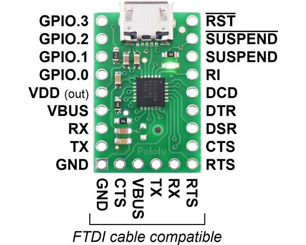

I have one of these .....
It works with a Pico with the UART set to MIDI baudrate
and running the script.
I would like to go directly from USB to the synth board.
I now have this ....
I think it will convert USB to MIDI , but haven't a clue
how to program it ????
The code below shows a datastream ( strangely ? ) off
the TX pin.
import serial
#Serial takes two parameters: serial device and baudrate
ser = serial.Serial('/dev/ttyUSB0', 9600)
while True:
   ser.write(bytes([144,60,127]))

The CP2102 is a USB to serial bridge. Windows sees it as a USB device and creates a COM port for it. It doesn't require programming, that's done by changing baud rate etc. on the virtual COM port that windows creates when it sees the CP2102. The baud rate for the CP2102 is set by changing the settings of the virtual COM port.
The serial I/O connections on the CP2102 are at 3.3V logic levels and I suspect would need some conversion to connect to MIDI, which IIRC uses opto couplers and 5V supplies.

The CP2102 communicates USB to a PC, where you can use a terminal program or you can use MMB4W or MMB4DOS or MMB4L to send data to it. Although the connection between the PC and the CP2102 is USB, and can use various speeds, the serial connection (UART) needs to have the correct baudrate before the MIDI module will understand.
If you look at wikipedia, you can see that the serial baudrate for MIDI must be 31.25kbps. If you can set this exact baudrate in your program (Maybe the CP2102 does not support this baudrate) you should be able to send commands to the module.
Connect ground to ground, and the CP2102 TX PIN TO  SAM2695 (the chip) pin 16. Not sure what the module pin is.
When (after careful trying) it does not work, maybe you need to invert the TX signal (the MIDI circuit is not shown in the board documentation, so I am not sure you need an inverter or not).

The CP2102 includes a set of registers, a programmable baud rate generator and a UART. It transfers data over its TX and RX pins at the speed set by the baud rate generator. The host device writes to the registers on the CP2102 to define communication parameters such as baud rate.
The USB link runs independently to the CP2102 TX and RX pins. It can transfer data much faster than the baud rate generator can clock the UART.

Some (most), but not  all USB-TTL adapters can set their baud rate to any value. Others are restricted to the 'standard' values.
For some, it depends on the operating system and the drivers.
Your choice of CP2102 was fortunate.

The CP2102 is a pretty old chip now and there are nicer alternatives. Some of the cheap boards that use it seem to be using some rather dodgy clone chips that have some very poor characteristics.
Be careful with VDDout. It comes from a tiny voltage regulator and is ok for pull-up resistors but not that much more.

  Mixtel90 said  Be careful with VDDout.
I'm using VBUS to power the synth and that
works ( possibly some noise )
Maybe I should try VDD ?
my site
Posts: 8911
Posted: 04:34pm 21 Jul 2022
VBUS is 5V from the USB. VDD out is supposed to be 3.3V, but sometimes it isn't! There have been cases of it being at 5V. The *total* current output from the regulator is supposed to be 100mA, in theory you have about 90mA available at 3.3V. Don't take this as gospel without testing it (gently) on dummy loads first as the Chinese take a remarkably flexible view of specifications. You may need to put decoupling caps from VDD to GND at the module.
