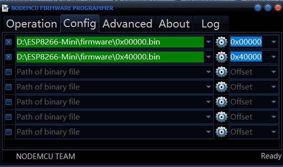

Firstly where can I get the .BIN files for this (or later versions) and, secondly, what is needed for the flash.
I have played around with NODEMCU Programmer and seem to be able to load various firmwares into the ESP8266-Mini but none of them work as the old one did with responding to AT commands etc.
I now cant get it back to a `working' i.e. responding to AT commands.
Can someone please point me to the required .BIN files and which order and addresses that I need to put them into the NODEMCU PROGRAMMER config screens as shown below..?
I have flashed (presumably successfully) many firmwares into the device and can see text in TeraTerm when I press the Reset button but none of the firmwares do what I want..
Reiterating again,
I would like links to a later version of the `standard AT command' firmware that I currently have
PLUS
which files I need to put into the config screen for NODEMCU and the starting addresses.

I have googled that statement a thousand times and I only end up more confused than ever,
From what I have gathered there is a myriad of software out there for the ESP866 many of which goes to GITHub links but they are so confusing to me. They all seem to have .BIN files for various things but nowhere have I found a simple link that shows an idiot like me which files to use AND which order they need to be loaded and at what address they need to be loaded into.
I know I haven’t killed my ESP8266 as I can get responses from it after every flash I do when I hit the RST button but I can no longer receive any response to any AT command let alone the version no.  AT+GSM command.
Baud rate almost always defaults to 74880 instead of the old default of 115200 (I know there is a command to set it but you need the AT set enabled first).

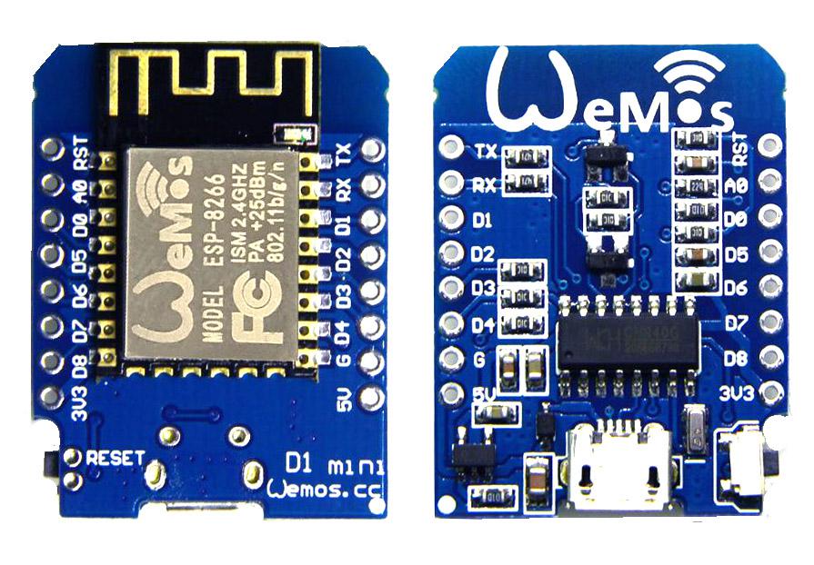

This is the link I bought QTY 4 of, I have since realised there are different memories, these are 4MB ones.
I bought another, locally, that ‘supposedly’ has 16MB memory, I am not game -  yet - to try flashing that one.
They look identical including the text in the chip. hmmm

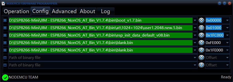

  TassyJim said  ESP8266_NonOS_AT_Bin_V1.7.4.zip
In the ZIP is a readme.md file which gives you the memory locations to load the various files into.
@Jim,
Thank you very much I think that is what I needed (besides a poke in the eye with a sharp stick).
I now get a response to the AT commands (well some of them) as follows:

I use an FTDI (3v3 version) USB-Serial-TTL cable and connect the D1-mini as follows:
FTDI    D1 Mini
5V   -    5V
Gnd  -    G
Rx   -    Tx
Tx   -    Rx
Then
Gnd   -   D3 (aka GPO0)
I then set up NODEMCU FIRMWARE PROGRAMMER  to point to the files in Jim's ZIP and set the memory locations for each as per the ReadMe file in the ZIP (settings shown to the right of the files in the following Screen shot)
Then I power my FTDI cable
Then in the Programmer,
Select the Com port to use (COM13 in my case)
Select Operation,
Select Flash
Very quickly you should see the AP MAC and SAT MAC as well as a QR code appear.
The progress bar starts incrementing and after roughly 1-2minutes it finishes with a GREEN tick.
Remove the GND from D3 on the D1-Mini and using Tera Term set for 115200 baud press the D1-mini reset switch.
If all worked you should see a bunch of gibberish followed by `ready'.
It is now ready for commands.
Thank you all for the assistance in this regard and I hope the above helps you update as well.

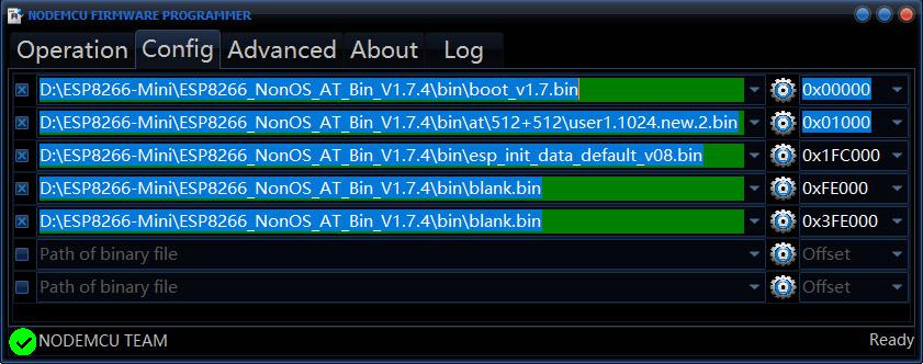

In any case after much trial and error by AndrewG and myself, Andrew came up with the following options (one of many listed in the files Jim sent but was supposedly for 16MB modules) and it seems to work fine EVERY time.
Using those files addressed above from the files Jim Uploaded I can confirm that the flash process I described with the files and addresses  shown in the above image works EVERY time.
Here is Jim's File file upload again.
Andrew and I hope that this will be of some help to others using the ESP8266-Mini (aka NodeMCU D1-Mini)
