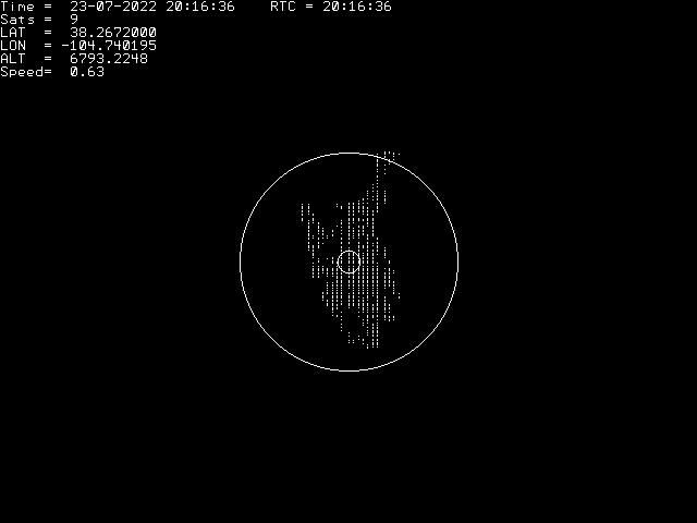

Here is an example Plot on PicoMiteVGA
This was taken with the GPS receiver in my basement work-room where reception is very poor and the WAAS data is not received.  The scale is 1pixel/foot and the small circle is 10ft radius with the larger circle at 100ft radius.  You can clearly see the "granularity" in the position data.
-Carl

  Sasquatch said  Here is an example Plot on PicoMiteVGA
Interesting plot Sasquatch, are you able to upload the code that generated this plot please?
Doug.
Doug.
I can upload it soon.  It's a work in progress, I need to clean up the code a bit and I want to add the option to scale everything in meters.  So give me a day or two and then I will upload what is working thus far.
There are lots of possibilities here including storing some basic maps on SD card and overlaying the GPS track in real-time.  I also want to be able to use an LCD display for portable use.
-Carl
