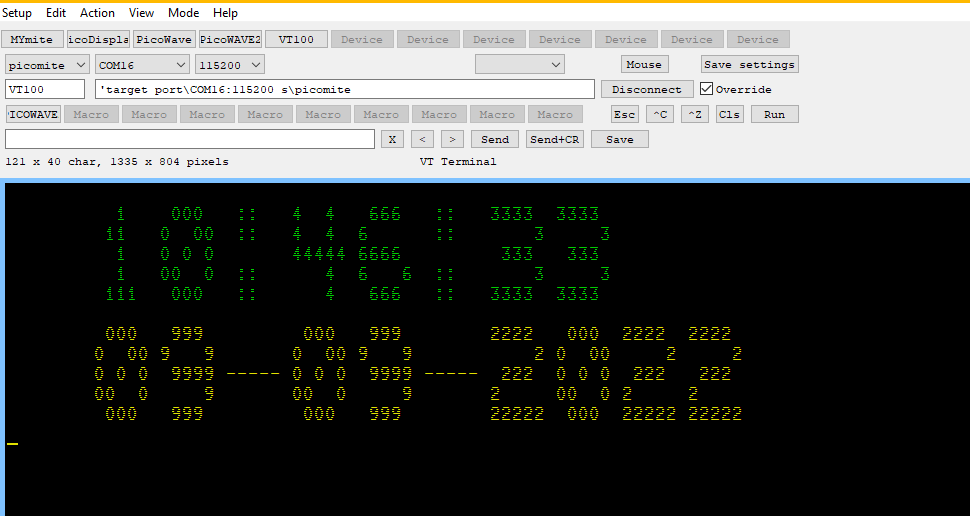

Still goofing around with a clock.
And now that I'm a bit more comfortable with MMBASIC and having found EPOCH() and DATETIME$()... my code just got a LOT simpler.
This is only a couple of lines of code to create this.
So... THANK YOU!

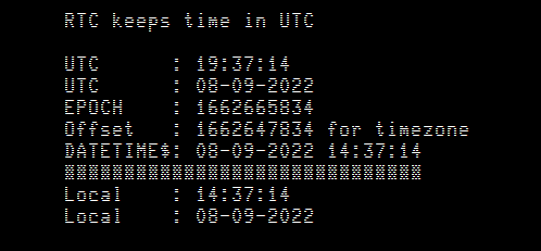

More progress...

here's a tip for you:
Epoch is commonly called "Unix Time" because Posix based computers counted seconds in that manner and for many their first exposure to Epoch times was the time sysvar of *nix machines. It has spread far and wide since.
Now-a-days, a lot of systems count milli-seconds in their Epoch times (hence they are 13 digits, not 10). You can use the internal timer of MMBasic to keep Epoch time in this manner because it increments in milli-seconds.
so something like
Timer=Epoch(Now)*1000
... will set the Timer to a real time and always has it in Epoch/Unixtime, just divide it by 1000 when you want to use it. Beware timer drift though; RTC Gettime doesn't set the Timer
Edited 2022-09-10 01:55 by CaptainBoing

Posted: 03:54pm 09 Sep 2022
Very Interesting... (Arte Johnson voice)
I'm not sure how much this will help at this stage of coding.  I currently pull time from RTC every 10 minutes to update the internal time-keeping.
I will say that moving to the use of UTC and EPOCH time changed things for the better.

Posted: 04:05pm 09 Sep 2022
  pwillard said  ... moving to the use of UTC and EPOCH time changed things for the better.
two rare absolutes in date processing, everything can be worked out fairly easily if you have those.
