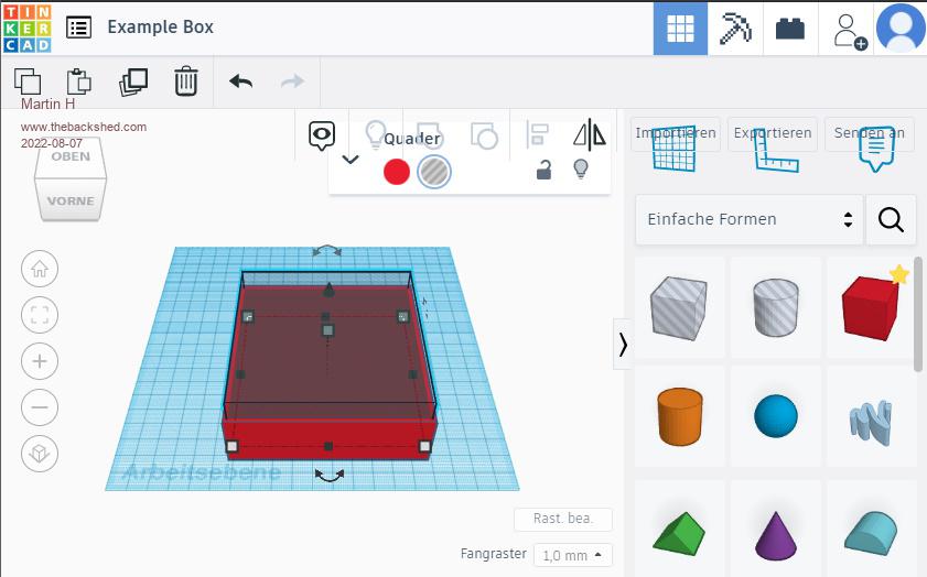

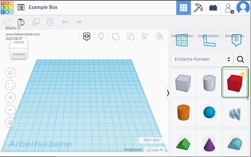

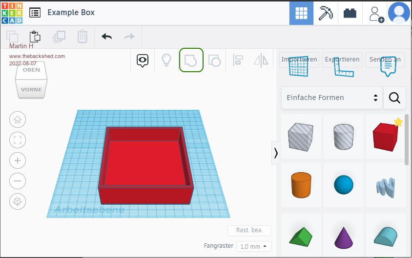

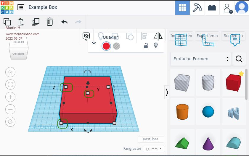

I edit or create or edit STL Files online at https://www.tinkercad.com/ (by autodesk).
You might also use the Windows 10 3d editor or Blender (for more sculptural use).
Or use Fusion 360 (not self-explanating and more for the technical us, but somehow free)
STL files are common, so most CAD applications should be able to read or export them.

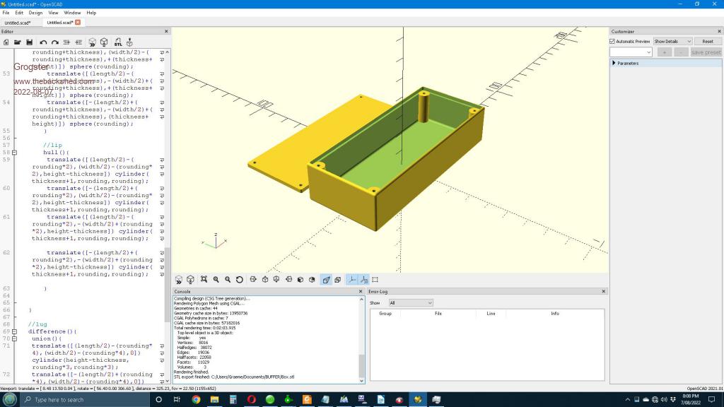

openscad is trivially easy to use for what you want. There are lots of good tutorials available
In your case:
Draw a box the size of the outside of the case
Subtract a box the size of the inside of the case
Subtract boxes the size of the openings
Generate SPL
Done
I absolutely guarantee you that learning a 3dCAD program such as FreeCAD is harder
