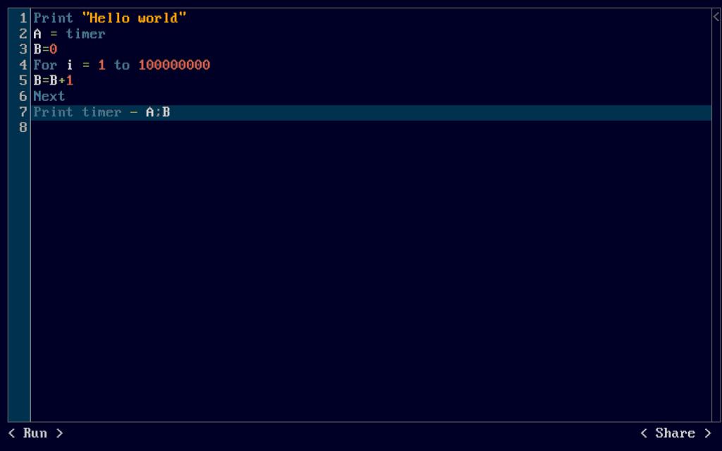

This increments a variable to 100_000_000 in less than 5 seconds on my Android tablet.

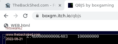

Posted: 10:30pm 20 Aug 2022
Not bad on a Tinker Board either

I'd say it is incrementing TWO variables from 1 to 100000000.
B and i.

Yeah - I can't understand the logic behind having B at all.  <confused>

  Mixtel90 said  Yeah - I can't understand the logic behind having B at all.  <confused>
An empty for-next can be misleading.
For example, the ByPic executes ~400,000 lines/sec but an empty for-next runs 1,280,000 times/sec.

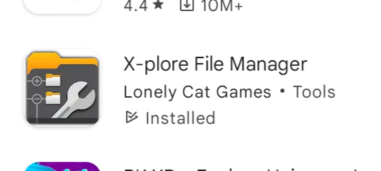

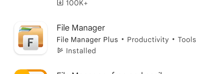

Oh I haven't used 'Files' since forever.
These are my gotos:
Using the Microsoft optimizing compiler (PDS) with an empty FOR-NEXT loop just sets the index variable to the final count+1. It doesn't actually count through the numbers since there's no need.
FOR i%=1 to 1000
NEXT i%
does something like this:
mov _I%,03E9
so it's important for PDS and similar compilers to actually do something in the loop if you're benchmarking a routine on different machines.
