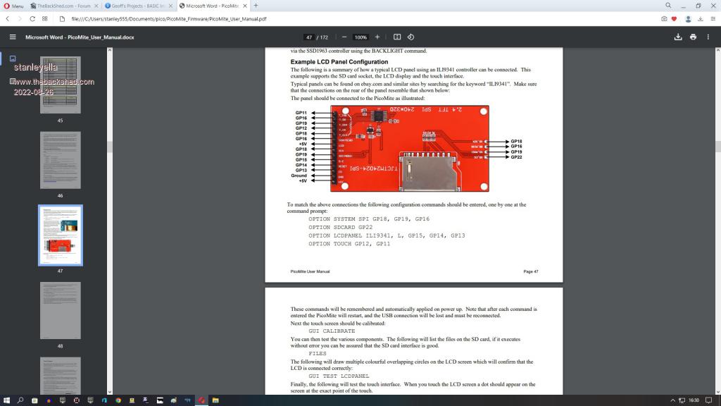

Posts: 2807
Posted: 03:26pm 25 Aug 2022
Paul, I think @panky is correct. You are using the vga mmbasic nanual.
from Geoff's mmbasic site I downloaded
Downloads
User Manual (170 pages including a BASIC programming tutorial) DOWNLOAD
PicoMite firmware V5.07.04 (includes the above manual). DOWNLOAD
Known bugs and issues DOWNLOAD
In that manual see image from
page 47
Posts: 2807
Posted: 03:56pm 25 Aug 2022
That is the "ili9341 manual". All the pixel, line, circle, box, etc. just work.
MMBasic does not use libraries for lcd devices as Arduino does... or gcbasic, which calls them include files.
I found if I wired the ili9341 as the instructions correctly (we all make mistakes :) )
then read the manual carefully, it works very well. IMHO the mmbasic graphics for this lcd are excellent. It is fast for spi. Hope you get it working.

Posts: 8911
Posted: 07:12am 26 Aug 2022
They are a bit different in concept, but with quite a bit of overlap:
PicoMite
Think of it as an embedded controller that can support a LCD display. You can have touch control with the right display. Although a PS/2 keyboard is supported and it's possible to use the display as a console it's not a lot of use as the text is too small and the scrolling speed is poor. These disadvantages are alleviated if you use a parallel-connected display but they use a lot of I/O pins. If you program it via the console you don't have to have a display anyway.
PicoMite VGA
Think of this one as a 1980's home computer but with a much better BASIC. You can have a much bigger (physically) display so it's quite possible to use it for programming and console connection isn't needed for most purposes. The PS/2 keyboard is normally used. There is no touch screen support so, if you want to use it as a control station, you need to consider how you would do your displays in BASIC. You still have access to all the I/O pins, of course.
You can, of course, swap a Pico from one to the other simply by loading the appropriate version of the firmware.
