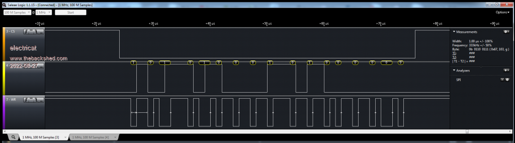

Using logic analyser I reverse engineered custom LCD driven by HT1621.
It would be easy task for any PIC microcontroller I am comfortable enough to decode such stream, but what about PicomiteVGA ?
Was thinking attach in the middle to signals sent by microcontroller to HT1621.
Read data, decode and send to  VGA screen using PicomiteVGA :)
DATA is clocked out on rising edge of WR signal at every 1-2 uS . It is pack of 17 bits sent in 50 uS x 10 bursts totaling in about 1mS for all pack of LCD information.
I failed read data using interrupts at 1uS rate with PicomiteVGA.
It might easily be my incompetence in MMBASIC for PicomiteVGA of course. But is it technically possible deal with interrupts without jitters at 1uS rate at all ?

This was my attempt to read data.
I see interrupts are kicking in both CS and WR, but results are out of order.
I should see for example something like BIN 101|000110|11111010 e.i. DEC 83706, but it looks like I catch only max 4 bits (out of 17 bits during 50 uS long CS) !

  Quote  But is it technically possible deal with interrupts without jitters at 1uS rate at all ?
No: interrupts are polled at the end of each Basic statement. There is no chance of doing what you want in Basic

The picomite executes basic commands at roughly 200000 per second. If you want to capture signals you need a minimum of 5 instructions. This limits your capture speed to around 10us. Anything faster is cannot be done in basic.
A CSUB runs arm code and will be faster.
The PIO in the rp2040 could be used, but will require pio code. Maybe there is some code on the internet.
But what is your aim? Do you want to attach a VGA screen to a LCD to show the same picture or data?
You did not mention, but in caae it is serial data you ccould capture it using the hardware SPI and maybe keep up with the speed

Master who sends signals is n76e003at20. It`s 8051-based Microcontroller.
And receiver, LCD driver HT1621B is low speed serial thing accepting 4-300khz.
They did not used n76e003at20 hardware SPI pins either, but clearly serially bitbanging. And clock seems to be quite unstable 1-4 uS . Was not sure rp2040 hardware SPI would like this. But this was not a "stop" for me to try.
After CS goes low they sent 17 bits of data in one go. First 3 bits for WR command, then 6 bits LCD`s RAM adress then 4+4 bits DATA. Then CS goes HIGH/LOW and next data part comes. Ok. I decided skip 3 first bits (they are of low importance) using CS interrupt and calculate time to wait and then read 16 bits. Or read 16 bits and ignore for a while 17-th just to see if PicomiteVGA hardware SPI would take on it. (I didn`t know picomite SPI function has 32 bits. manual says 4,8,16)
So I tried :)
But MMBASIC threw me "not all pins set for SPI".
Tried different ways. Did not found error reason. Should be something stupid I miss.

As by decision, I ended up using PIC`S hardware SPI in slave mode with CS independent line. After simple time synchronizing routine  I`m starting read non stop bit to bit stream  into 20 byte array.
On interrupt each new byte reads from SSP2BUF and while SSP2ADD fills in with new bits, there is enough time for few simple interrupt routines. Used for task PIC18F24k22.
Done. I can now do whatever I want as there is almost 500 uS time gap for sorting out received data and decoding things
