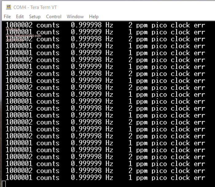

Posts: 5931
Posted: 12:22pm 09 Sep 2022
Calculating the accuracy of the picomite crystal oscillator compared to a GPS clock.
This picomite board is particulary accurate.....

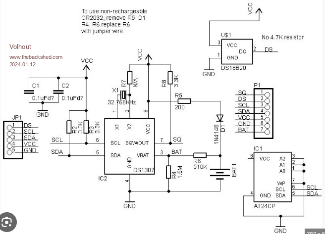

Posts: 3291
Posted: 02:16am 11 Jan 2024
While awaiting the arrival of some DS3231 modules brought the DS1307 out if retirement and found it had lost 2 weeks. The CR2032 cell still reads 3.02V yet it does not loose time when powered from 3.3V.
The module doesn't have any decoupling capacitors so perhaps the internal resistance of the cell is the issue. Added a 1µF ceramic SMD to the cell supply a few days ago and so far it has gained just 2S. Much better!
Perhaps all the instability noted in the posts above are due to this simple omission.
The cap is mounted on the top of the board from the 3V plated-through pad to the ground pad under the crystal.
Posts: 5931
Posted: 09:34am 12 Jan 2024
Hi phill,
I did put the capacitor at location R4 on the circuit board (years ago).
Posts: 3291
Posted: 11:49am 12 Jan 2024
After keeping within a couple of seconds for the past 3 days it lost almost ½ hour today so shifted the cap to R4 as you did. It seems demented.

JanVolk
Joined: 28/01/2023
Posts: 379
Posted: 06:56pm 12 Jan 2024
phil99 and Volhout
For DS1307
Take a look at the datasheet at Supply Voltage
Vcc Min=4.5V Typ=5.0V Max=5.5V
Nice day
Posts: 3291
Posted: 09:42pm 12 Jan 2024
This particular DS1307 keeps time with good accuracy (after replacing the crystal) when powered from 3.3V, but becomes unpredictable when unpowered, running on it's coin cell.
It will keep time for days then abruptly loose a big lump.
With Volhout's mod. (1µF across R4) it remained within 1S overnight unpowered.
Will experiment with unplugging the module before powering down the Pico.
That should prevent I2C errors affecting it. Also removed RTC AUTO ENABLE.
Edit.
Having been prompted to re-examine the data sheet the min/max Vbat is 2.0/3.5V. Measuring Vbat with a 10MĪ© meter gives 2.1V which is a bit close to min., allowing for meter loading.
I suspect the original version of this circuit used a 3 cell NiCd battery which could be up to 4.5V on charge. Hence the voltage divider.
I will remove R4 and the charging resistor to see if that helps. A little less drain on the cell as a bonus.
Edit 2.
After removing R4 Vbat is now 2.8V but it now won't run at 3.3V so now powering from 4.8V Vsys with S. diodes from the I2C pins to 3.3V.
Edited 2024-01-13 14:04 by phil99
JanVolk
Joined: 28/01/2023
Posts: 379
Posted: 07:12pm 13 Jan 2024
For DS1307
Vcc:  Min=4.5V Typ=5.0V Max=5.5V
Vbat: Min=2.0V Typ=3.0V Max=3.5V
Make sure that the SDA and SCL pullup resistors are not connected to 5V. (With Raspberry Pi Pico)
Make sure that the diode does not have too much voltage drop when charging at 3V3, otherwise use a 5V charging scheme or a separate 3V CR2032 button cell.
For example, I had a Raspberry Pi RTC clock module where the yellow button cell was defective. Removed this button cell and disabled the SCL charging resistor by unsoldering pin 14 of the chip and connecting a wire to the loose NC pin to which I attached a loose 3V CR2032 button cell.
And I have the impression that this makes the DS3231's clock run more accurately.
Nice day
Posts: 3291
Posted: 09:59pm 13 Jan 2024
  Quote  For DS1307
In practice most DS1307 chips will run with Vcc = 3.3V and this one had done so for several years, though the accuracy was much less than a DS3231, until the crystal was replaced. That improved it quite a bit.
The main issue was unreliability when running on it's battery.
The circuit is the same as in Volhout's post. It has a charging diode and resistor yet is fitted with a non-rechargeable 3V CR2032 cell. This didn't matter when powered from 3.3V. The 200Ī© resistor has now been removed.
It also has a voltage divider between the battery and Vbat, this is not needed for a 3V cell and was reducing Vbat close to the minimum.
Now that I am running Vcc from 4.8V to protect the Pico I2C pins Schottky diodes have been added from them to 3.3V. In practice, the Pico pins can tolerate pullup resistors going to 5.0V. The RP2040 datasheet is conservative.
So far it has kept time with these mods but because of it's unpredictability I will need to wait at least a week.
