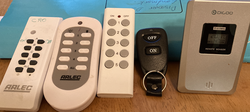

The CSub and program can successfully receive codes from each of these devices.
Two versions of the ARLEC and an ebay 240V switch, a key fob and the DIGOO humidity and temperature sensor.

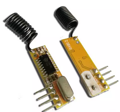

I used an RXB12 receiver which works at 3.3 volts. if you use one that requires 5v you will need a level shifter or voltage divided on the data line.

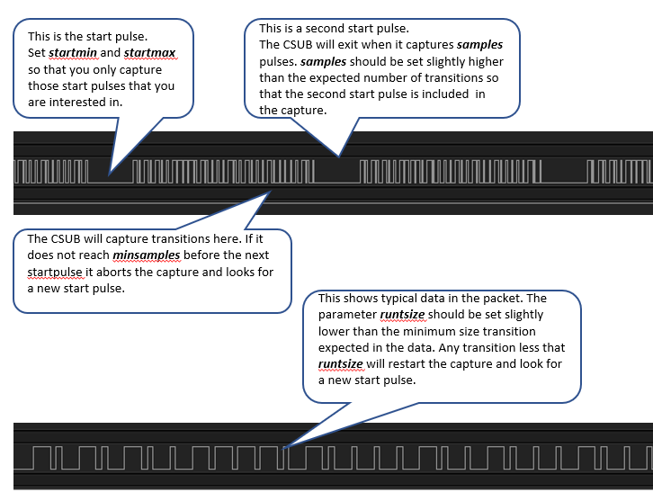

Setting CSUB Parameters to filter noise
The addition parameters on this new CSub are listed below, along with some hints on setting the values. The aim is to have the CSub discard as much noise as possible before sending an interrupt to MMBasic for it to decode the data captured.
' This CSUB logs activity on GP6 the COUNT1 pin., each transition of the pin is
' logged to the nearest microsecond. The timestamp is positive for positive
' going transitions and negated for negative going ones
' LOG mode,times(),samples,minsamples,timeout,startmin,startmax,runtsize
' The parameters are:
' mode     : 1 to enable, 0 to disable
' times()  : an integer array to hold the timestamps
' samples  : an integer with the number of samples to capture (the array must be at least this big)
' minsamples :an integer with minimum no of valid transitions after a start before its considered valid
' timeout  :an integer giving a timeout in microseconds for the CSUB to terminate
'          :if the number of sample requested is not reached. 0 for no timeout period.
' startmin : minimum transition in uSec that will be considered as a valid start pulse
' startmax : maximum transition in uSec that will be considered as a valid start pulse
' runtsize : minimum transition in uSec that will be considered as a valid data
' A valid start is a transition > startmin and < startmax and is a positive going transition.
' If during the capture after a valid start is detected another start is detected before minsamples is
' reached then this is considered noise and the capture will restart.
' A transition less that runtsize will be considered noise and restart the capture.
' A transistion greater that startmax is considered noise and will restart the capture.
' These can be tuned to eliminate false captures due to noise.
' When either the timeout(if enabled) occurs or the number of samples is reached the
' CSUB triggers an interrupt so the Basic program can then analyse the captured data.
