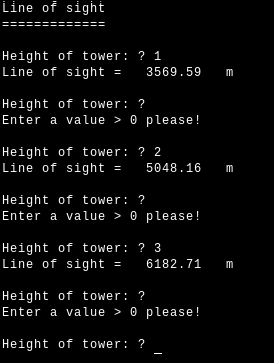

I found that I get a 2nd INPUT value after each calculation which has the value <=0.
So I had to put in a "busy loop" after each calculation to prevent this.
do while inkey$ = ""
loop
When I use the CMM2 only with keyboard and no terminal connection I don't need the busy loop. So INPUT works correct but not within an MMCC terminal session or the terminal puts in some additional values which are directly feeded into the next INPUT.

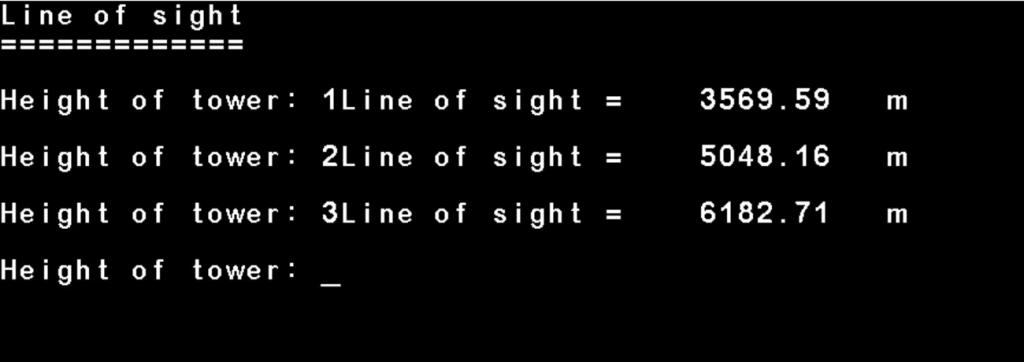

It's strange in a different way with the Windows version (no INKEY$ loop) as well:
Edited 2022-09-19 04:47 by toml_12953

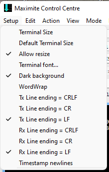

In MMCC, set the Tx line-ending to 'LF' rather than CRLF.
I find that for the picomites, setting Tx and Rx both to LF is the best option.
You would need to do the same with TeraTerm.

I tried that LF for both Send and Receive but it didn't change the behaviour. Same with CR for both.

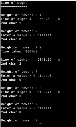

Then I inserted a PRINT statement which prints the 'towerhight' INPUT value and I found that the second value is "0"
changed program:

I stopped & powered off the  MMCC & MMEdit and the CMM2. After switching on the setup shows LF for TX and RX - my latest test. And now it works.
So it seems that the MMCC Setup change needs a complete restart.

Posts: 4380
Posted: 06:53pm 19 Sep 2022
Looks like it was "0" because it was a blank line (an extra either CR or LF).
When you read a numeric it will be set to 0 if the input is just a line terminator.

In my tests on Linux, the menu changes to the line ending settings take effect immediately. There should be no need for any restart.

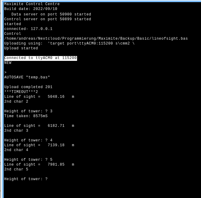

Looking at your screenprint, I assume that you loaded the bas file by dragging and dropping onto the desktop shortcut. That is the only reason I can give for the connection to the control port.
Not a problem, just interested in how the program gets used.
The date of your MMCC is 10th Sept. There is a 15th Sept version posted which fixes Linux printing.
You also didn't have the connection to your picomite configured, MMCC thinks it is a CMM2, the old default. That might explain the Timeout. If you setup a connection for the picomite and preferably save it as a device setting, MMCC will use the last setup each time and life will be easier for you.
No, I'm clicking the "Load file and run it" button within MMEdit
  TassyJim said  Not a problem, just interested in how the program gets used.
Oh, I will download the latest version and test it!
  TassyJim said  You also didn't have the connection to your picomite configured, MMCC thinks it is a CMM2, the old default. That might explain the Timeout. If you setup a connection for the picomite and preferably save it as a device setting, MMCC will use the last setup each time and life will be easier for you.

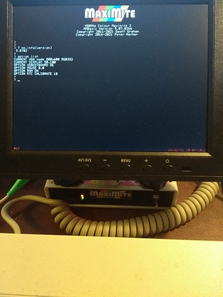

I'm using MMEdit with my CMM2 (!) - the USB power connector is connected to my main PC running Linux (Mint Version 21 "Vanessa") So the Colour Maximite 2 gets its power and control by the USB cable.
I have setup CMM2 with ttyACM0 115200 within MMCC as MySite
