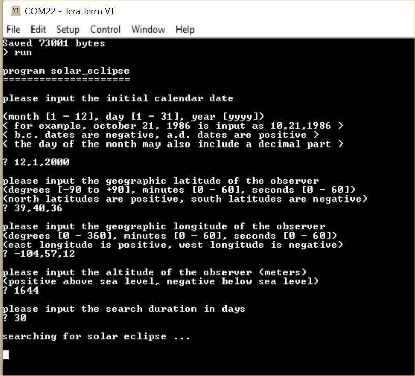

Posted: 05:55pm 29 Sep 2022
Hi Peter,
XMODEM may be borked.
Demonstrated with PicoMiteVGA + TeraTerm on Windows 10
(but originally seen with PicoMiteVGA + MMB4L as the XMODEM sender)
  1. Start TeraTerm, connect to PicoMiteVGA
  2. On the PicoMiteVGA: XMODEM RECEIVE "lazer-cycle.bas"
  3. From TeraTerm: [Transfer->XMODEM->Send...] "lazer-cycle.bas"
  4. On the PicoMiteVGA: RUN "lazer-cycle.bas"
     - don't look too closely it's not cooked yet.
  5. On the PicoMiteVGA: CTRL-C
  6. On the PicoMiteVGA: XMODEM RECEIVE "lazer-cycle.bas"
  7. From TeraTerm: [Transfer->XMODEM->Send...] "lazer-cycle.bas"
  8. The transfer hangs without getting past the first 512 bytes.
I think you need to be sending a reasonably large program, and I suppose it is possible that "lazer-cycle.bas" is doing something that breaks it, but what could that be ?
I think this may have been working in one of the late betas, but it is possible that something in "lazer-cycle.bas" has changed since then, it has certainly got bigger.
   lazer-cycle.zip
Apologies that I won't be available to answer any follow-up questions this evening.
Posts: 10233
Posted: 06:14pm 29 Sep 2022
Worked perfectly when transferring/running 73000 byte file exactly as above (solar_eclipse) so you will need to try and find what you are doing that causes the problem in order for me to have a look
