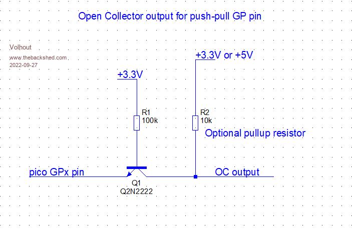

| Volhout Guru Joined: 05/03/2018 Location: NetherlandsPosts: 5930 |
@OA47 If you require this pin only to be OC output (not bi-directional) then this could help you. ![]() The transistor can be any small NPN. Regards, Volhout PicomiteVGA PETSCII ROBOTS |
| phil99 Guru Joined: 11/02/2018 Location: AustraliaPosts: 3289 |
Just a schottky diode, cathode to pin, anode to pullup will do the same thing. If you need to switch between DOUT and DIN reduce the pullup to 2k2 and put a 22k across the diode. . Edited 2022-09-27 23:00 by phil99 |

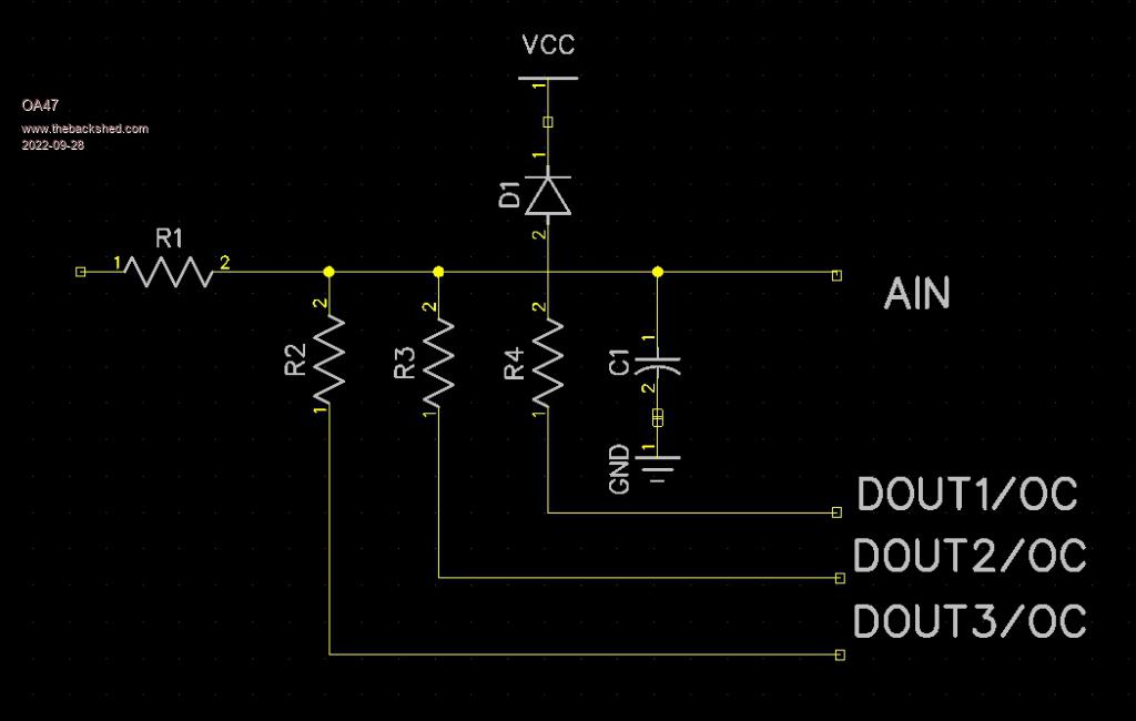

| OA47 Guru Joined: 11/04/2012 Location: AustraliaPosts: 1050 |
What I was trying to achieve is an auto ranging resistor network to measure DC voltages on the Analog IN pin. I have used this circuit on the ARMites and MicroMites. ![]() OA47 |
Ok now we know what is needed. For accurate readings the resistors need to be pulled to ground with a low resistance. The Pico pins are about 50 ohms, so even if OC worked accuracy would be reduced. Use 2N7000 or similar MOSFETS to pull them to ground. Invert your DOUTs as a high will pull the resistor low. |
I am not worried by the 50 Ohm resistance of the Pico pin as I use the software to calibrate the readings 0-100V. Typically in the past I used R1=1M0, R2=1M0, R3=100K, R4=10K. OA47 |
Hi OA47. Your circuit will work (I have used similar many times before), there is however one thing you should pay attention to. The protection diode. For this diode to work, it should be a shottky diode. And these tend to have high leakage (1uA). If you put that against 1Mohm input impedance, you will see a non-linearity error (that is also temperature dependent). That is why real multimeters use different protection methods, i.e. with silicon diodes (or even si transistors used as a diode) that have leakage currents in the pA...nA range. Most microcontroller IO pins have very high impedance when in input mode, despite the fact that the datasheet may say different. Not sure about the pico IO pins, but microchip pins where exceptionally low leakage when tested for it. Regards, Volhout PicomiteVGA PETSCII ROBOTS |
| Mixtel90 Guru Joined: 05/10/2019 Location: United KingdomPosts: 8904 |
Assuming you are powering the PicoMite from a 5V supply, one way might be to use a resistor and 3V9 zener (or, even better, a proper temperature-compensated shunt regulator like a LM334Z) to an "over voltage" point and use a conventional silicon diode with it's cathode to that rather than to VCC. That would give you protection above 3V3 with a lower leakage. Mick Zilog Inside! nascom.info for Nascom & Gemini Preliminary MMBasic docs & my PCB designs |
It seems even when I set the pin to DIN it puts out around 2.7v which is a similar problem to DOUT. OA47 |
