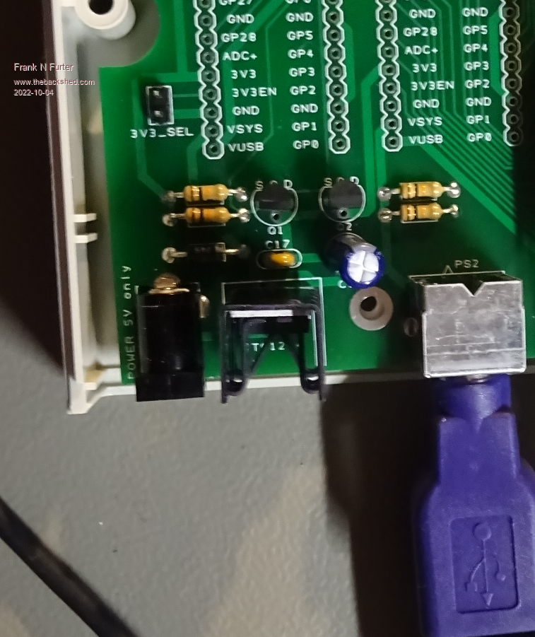

Hi,
i tried to convert the fantastic program PicoMite Solar System Clock to PicoMiteVGA.
It works (with MODE 2) but I have problems with INKEY$. I use "+", "-" and "r" for resetting the time.
It works as expected with Tera Term but when I use the keyboard, the program does not accept any more characters after some inputs ("+"). Sometimes it still responds to "r".
Why???
With Tera Term it still continues to work flawlessly...
If anyone wants to try it, here is my modified code (at the moment it is not possible to reach all calendar days...):

The picomite consists of a cpu module on a circuit board. To connent to the keyboard you need power and a 5V logic serial bus.
Old keyboards definitely need 5V power (more than 4.75V). Can you check if the 5V on the ps2 connector is 4.75V?
Then the 5V serial bus is created using a level shifter circuit (the pico is 3.3V). Do you use a le el shifter module? Or do you use discrete FET's?
Can you check that the level shifter works. (Without keyboard attached, are the clock and data pin 5V?).
If you use discrete FETs, are they in the correct orientation.? Maybe send a photo, and the type number of the parts used. It could be they are mounted reversed (there are different connections for parts that look the same from the outside).
From what you are saying, this could be a hardware problem, that is why the above questions.
Finally you could check what happens when you switch the keyboard option to US or UK (this is the default). If behaviour changes then we know where to look for.

Posts: 8904
Posted: 08:49pm 04 Oct 2022
I'd definitely look at the keyboard voltage - remembering that you can't power the keyboard from 5V (which it may need) and connect it direct to the Picomite pins!
Some PS/2 keyboards are partially functional at 3V3 but not reliable.
Also, if there is a level shifter using 2N7000 MOSFETs you need to note that in the usual circuit they are actually being asked to work out of specification - but they usually do in my experience.
Are you using one of the known PicoMite VGA PCBs Frank?
Posts: 11499
Posted: 09:29pm 04 Oct 2022
  Quote  Also, if there is a level shifter using 2N7000 MOSFETs
Also note 2N7000 do not guarantee to meet the spec in the application note. The mosfet I specify do.
Frank N. Furter
Joined: 28/05/2012
Posts: 1102
Posted: 06:45am 05 Oct 2022
Hi,
I have a PicoMiteVGA V1.3 PCB with two TN0702N3-G:
I have no other problems with the keyboard - I had used it successfully on all projects so far (Maximite, Duinomite, Colormaximite, Colormaximite2). It is a CHERRY G84-4100.
Am I the only one who has this problem with the above code???
I will try other keyboards and completely reset and reflash the µC.
Frank
Posts: 5927
Posted: 09:52am 05 Oct 2022
Hi Frank,
I tried your code on the same picomite PCB (Peter's design 1.4) and cannot reproduce your problem. Used a small PS2 keyboard. Both with key repeat, and with single key presses the data changes, as does the clock.
Tried with a different (older) PS2 keyboard. I can see no problems. There must be something related to your keyboard (since we use the same picomite platform).
Did you measure the voltage at the PS2 connector ? Looks like you power from the barrel connector. What diode do you use for D1 ? iN5819? Or 1N4001 ?
