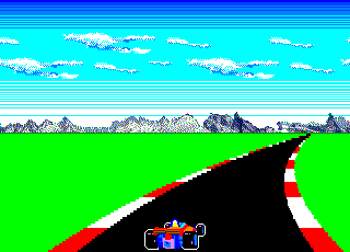

PicoMiteVGA MMBasic Version 5.07.05RC6
CPUSPEED 378000
Proof of concept..
parts of the concept are inspired by olc https://youtu.be/KkMZI5Jbf18
Dim Col%(15),Xofs%(160)
Restore colors:For f%=1 To 15:Read Col%(f%):Next f%
SH%=240:SW%=320
dist%=0:Speed%=15
Option Break 4: On Key 3, on_break
MODE 2
FRAMEBUFFER create
FRAMEBUFFER WRITE F
For f%=0 To 159:Xofs%(f%)=((160*Exp(f%/50))/20)-8:Next
CLS COL%(1)
HW%=SW%/2:HH%=SH%/2:t%=Timer

feel free to use and improve it,
if someone likes to write a Racing game for the Pico
if you want to drive straight ahead just do a loop with ofs%=0
Mart!n

Every single Frame is completly redrawn.
With the use of the Framebuffer I can redraws the screen hidden and make it Vissible when it is ready. This makes the screen animation flicker-free.
Here I paint the Lower half of the screen, green, then I draw Line by Line, the Border and the Street.
by giving up the get_BorderCol% Function call and replacing with
bc%=col%(7-3*((Sin((((150-f%)/40)^3)+dist%))>0))
this little demo gets up to 30 fps

Posted: 02:53pm 12 Oct 2022
  stanleyella said  @Martin.H
How do lines like bc%=col%(7-3*((Sin((((120-f%)/40)^3)+dist%))>0))
work in real time ???
The Spaces of the upper strips at the Border is less than the Lower ones,
for this:
f% is the y position of the Line and Dist% is just a Framecounter to simulate driving.
calculates a point in a Sinewave at which frequency increases starting with the Phase dist%
I use this to deside to use Color 7 (White) or Color 4 (Red) for the Border
the color value is 7 but subtracts 3 if the Result of the Sine-Function is Positiv.
Look at the Listing in the first Post.
It is the Function get_BorderCol%() from the Listing above in a conpressed form.
Cause every function call takes some time and it is called 120 times per Frame, so I put it in one basic Line.
The Idea for this method is from javidx9 (one Lone Coder) who used the same calculation in his video.
