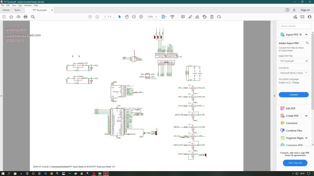

I just got handed 11 of These TFT Touch Sheilds from Seed Studios, does anyone have any ideas if I can hack them to a Picomite?
Posts: 11512
Posted: 04:48pm 13 Oct 2022
No: they are wired 8-bit parallel which is only supported for the SSD1963. Also, the touch screen does not have a controller so touch is not compatible either

The (PDF) circuit looks like they are SPI, but I've no experience of these.
Posts: 11512
Posted: 05:32pm 13 Oct 2022
  Quote  The (PDF) circuit looks like they are SPI,
Yes: I'm wrong about the display - sorry, shouldn't make assumptions based on the form factor. So it should work with the standard ILI9341 driver.
The touch is though an issue as the board just exposes the raw resistive x,y dividers

Rig one up on its SPI pins, use the ILI9341 driver and see what happens. It looks like you should be able to get the display and probably the SD card working. It'll be interesting to see what happens. :)  By changing a link on the display you should be able to get control of the backlight too so that you can switch it off and on or PWM it. The necessary transistor is in place.
Posts: 2807
Posted: 05:12pm 14 Oct 2022
It looks compatible but not sure what logic levels it uses from the circuit.
Posts: 8911
Posted: 05:30pm 14 Oct 2022
The display has a 5V input that feeds a 3V3 regulator (U3). The buffers U2 and U4 are being powered at 3V3 so they can accept 3V3. Each input has a 3K3 series resistor so I assume that inputs can also accept 5V. Outputs will be at 3V3, but that's within tolerance for 5V TTL.
A further regulator produces 2V8 for the display logic and backlight.
The base of the backlight transistor has 1K on it and is then linked to 5V to turn it on. Moving the on board link connects it to PD7 instead so it can be connected to a Pico output to control it.

I found this Pin Out of the LCD Does anyone know how I'd wire these pins to the PicoMITE and what option config I'd use on the PM to config it?
Thank you guys

Posts: 3290
Posted: 06:32am 22 Oct 2022
Looking at the PDF it isn't clear where to connect Reset, but this might work for the rest. A bit of experimentation may be needed.
OPTION SYSTEM SPI CLKpin, MOSIpin, MISOpin
OPTION LCDPANEL ILI9341, LANDSCAPE, DC, RESET, CS
Using the suggested pins.
OPTION SYSTEM SPI GP18, GP19, GP16
Where
D11 SPI_MOSI = GP19
D12 SPI_MISO = GP16
D13 SPI_SCK = GP18
OPTION LCDPANEL ILI9341, L, GP15, GP14, GP13
Where
D6 TFT_DC = GP15
RESET ? TRST ? = GP14
D5 TFT_CS =  GP13
Posts: 8911
Posted: 06:58am 22 Oct 2022
First - you can NOT use the PicoMite VGA firmware for this.
The TFT_xxx pins are control pins for the display
The SPI_xxx pins are for the SPI system
The touch panel pins are for....   (guess) - but we aren't bothered about those.
So it depends on which PicoMite pins you want to use use. You need a set of SPI pins and some to use as control pins.
From the manual....
You need SPI:
Try the ILI9341 driver:
OPTION LCDPANEL ILI9341, OR, DC, RESET, CS
OR is orientation - try L to be going on with
Now look at what you have to work with:
SPI_SCK is SPI CLKpin
SPI_MOSI is SPI MOSIpin
SPI_MISO is SPI MISOpin
These can be either of the SPI devices on the PicoMite - your choice.
TFT_DC is the DC pin (can be any pin as long as you specify it)
TFT_CS is the CS pin (can be any pin as long as you specify it)
RESET can be any pin as long as you specify it (It goes to TRST, which shorts out the reset input pin on the driver chip).
The SD card only needs a CS signal as the data pins are connected to SPI. So...
OPTION SDCARD xx
From the schematic, the CS pin on the SD card socket is on TF_CS so xx is the pin that you connect to that.

sorry Guys tried it 3 times and no Joy
Posts: 8911
Posted: 02:48pm 22 Oct 2022
What are you connecting where and with what options set?
Also, if you are messing about with changing options, you must use OPTION LCDPANEL DISABLE before you can set up new options.
Concentrate on just the display first. You'll need to set up the SYSTEM SPI and LCDPANEL options. The SPI pins must be on a valid hardware SPI port of the PicoMite.  Once they are set you shouldn't need to mess with them again.

Adding to the above, is the backlight enabled?
Maybe it is working but invisible.
Posts: 6538
Posted: 12:15am 23 Oct 2022
Forget the Arduino pin numbers, they only confuse.
Compare the schematic to the PCB layout and you will see which pins to use, including the RESET which you were missing.
