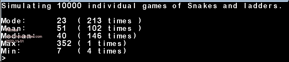

In the board designed below - interesting to see the range of rolls.
edit:  edited to return the index of the bin (ie roll value - and not just the count)

roll_mean = math(mean rolls())
roll_median = math(median rolls())
roll_max = math(max rolls())
roll_min = math(min rolls())
sort bins(), binindex()
roll_modal =  binindex(500)
print""
print "Mode:"roll_modal, "Mean:" roll_mean, "Median:" roll_median, "Max:" roll_max, "Min:" roll_min

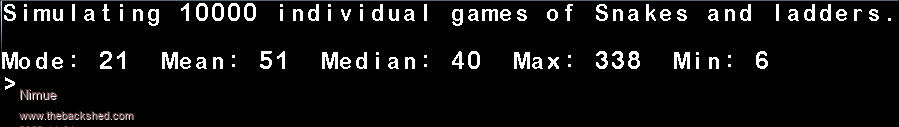

Nimue
Joined: 06/08/2020
Posts: 427
Posted: 01:36pm 01 Nov 2022
  Volhout said
Please note that the MATH(MAX ...) command allows you to read the max value, but also the index at which this max value occurs. So in one command you have the index, and the value....
Nice - updated, removed the unnecessary second array and the sort function.

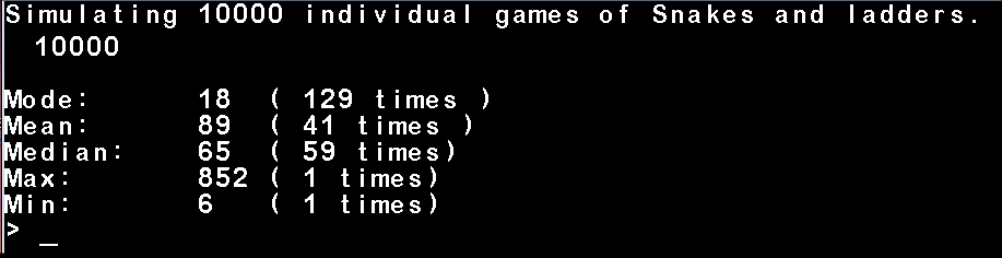

Posted: 01:57pm 01 Nov 2022
Not all boards are the same...
I imagine that 800+ rolls games would end with me tipping the board over
