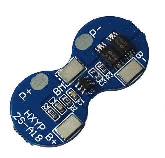

| lizby Guru Joined: 17/05/2016 Location: United StatesPosts: 3784 |
The single-cell 5V & 3V3 18650 modules that I have used will output while charging unless they have shut off when disconnected from power because of low-battery. Then I've found they will neither charge nor power the device, and you have to turn off the 5V USB switch to get them to re-charge. That pretty much defeats the purpose, but I fixed that by running a wire plus schottky diode directly from the 5V input power to the 5V USB pin (plus another schottky diode from the switch to 5V USB). Then it cleanly starts up when power is re-applied, and the battery slowly charges. I'll still try that 6-cell 12V 18650 pack. Maybe instead of 50,000mAhrs they mean 50,000mWhrs @ 12V, so about 4Ahrs. That might barely be plausible, though I suspect it's still high. I may also look at this claimed 10Ahr 12V UPS PicoMite, Armmite F4, SensorKits, MMBasic Hardware, Games, etc. on FOTS |

| Tinine Guru Joined: 30/03/2016 Location: United KingdomPosts: 1646 |
@lizby Kinda liking this schottky diode idea, actually ![]() Craig |

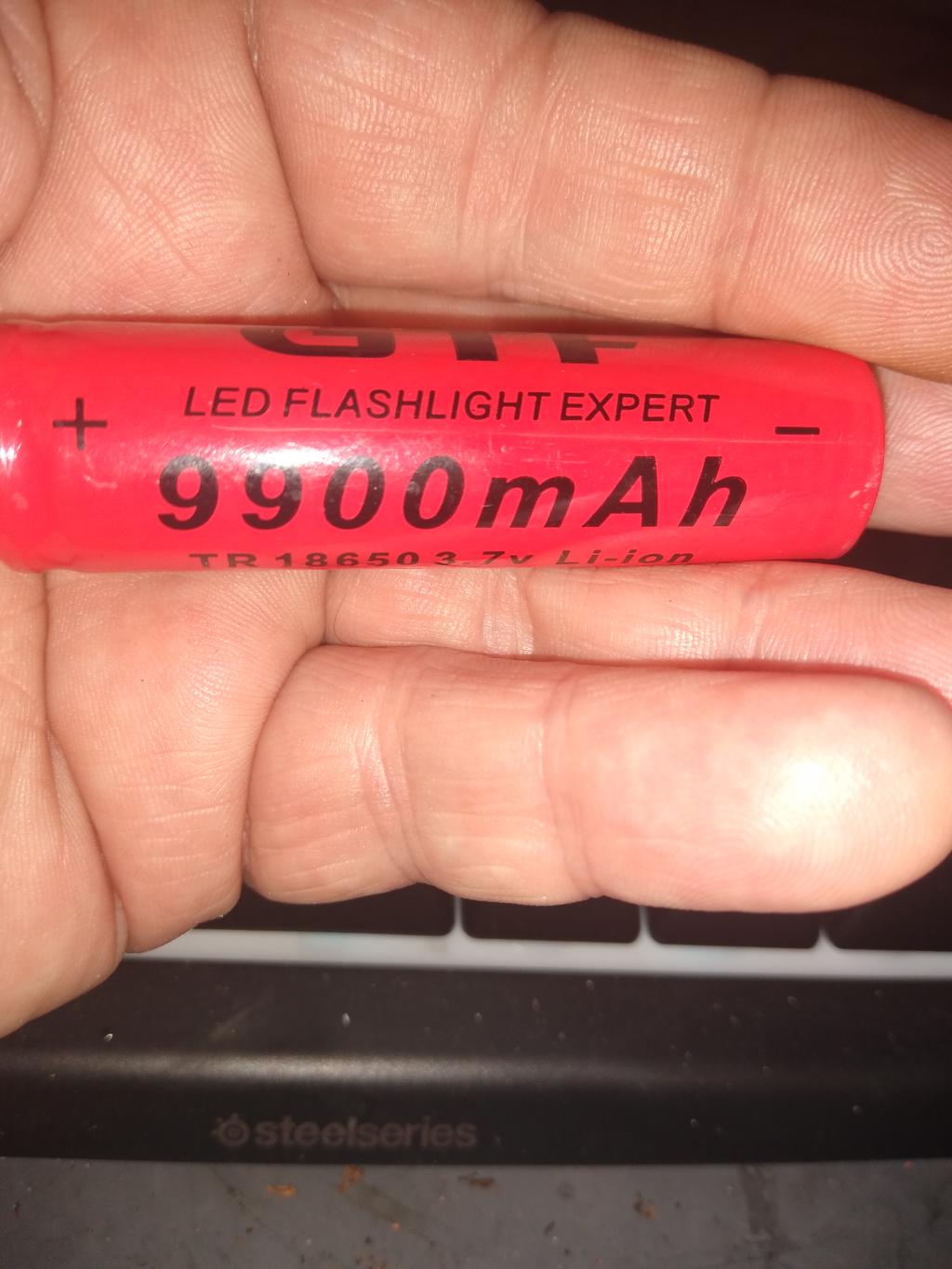

| Mixtel90 Guru Joined: 05/10/2019 Location: United KingdomPosts: 8911 |
You can easily get variable voltage from about 1v up to 50V out of a single 18650. Just use a buck-boost converter. You get shorter running times at higher output voltages at it depends on the Watts load. 2A at 12V is a 24W load. At 7.2V you'll draw about 3.7A from the batteries. At (a very optimistic "Chinese") 3Ah capacity you should get about 50mins run time. If you put 3 "Chinese 3300mAh" 18650s in parallel you get 10Ah (well, 9.9Ah, which is close enough for advertisers). You *might* just see it with new batteries but not for long. At 2V 2A out of the buck-boost converter you could be discharging the parallel set at 7.5A or so. Xtar claim a maximum current of 10A for their version so this looks possible, Mick Zilog Inside! nascom.info for Nascom & Gemini Preliminary MMBasic docs & my PCB designs |
