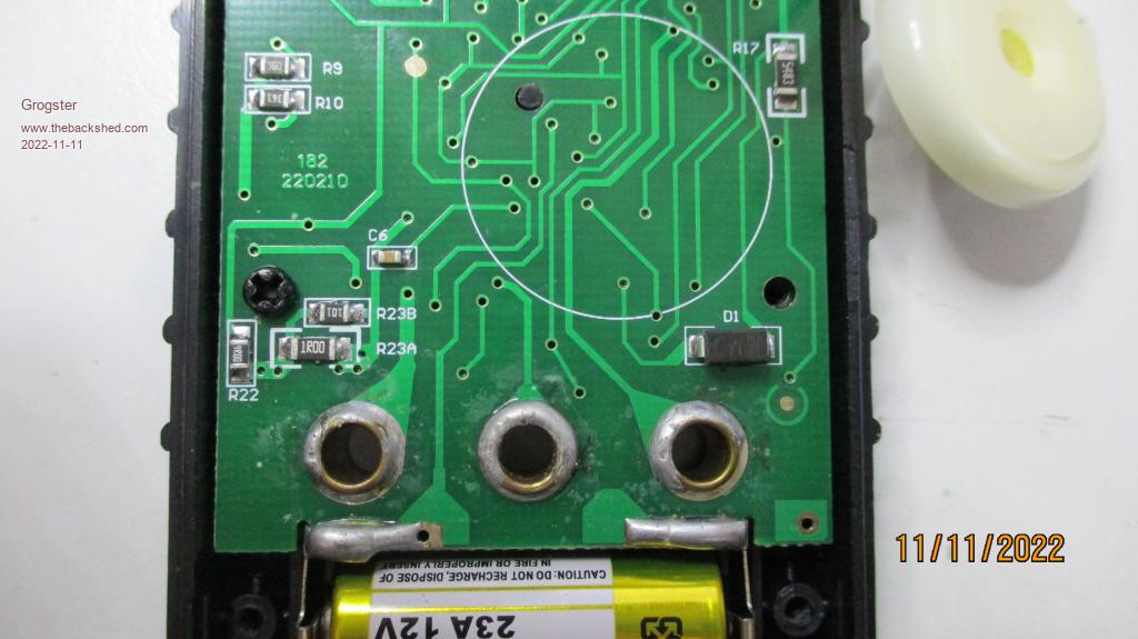

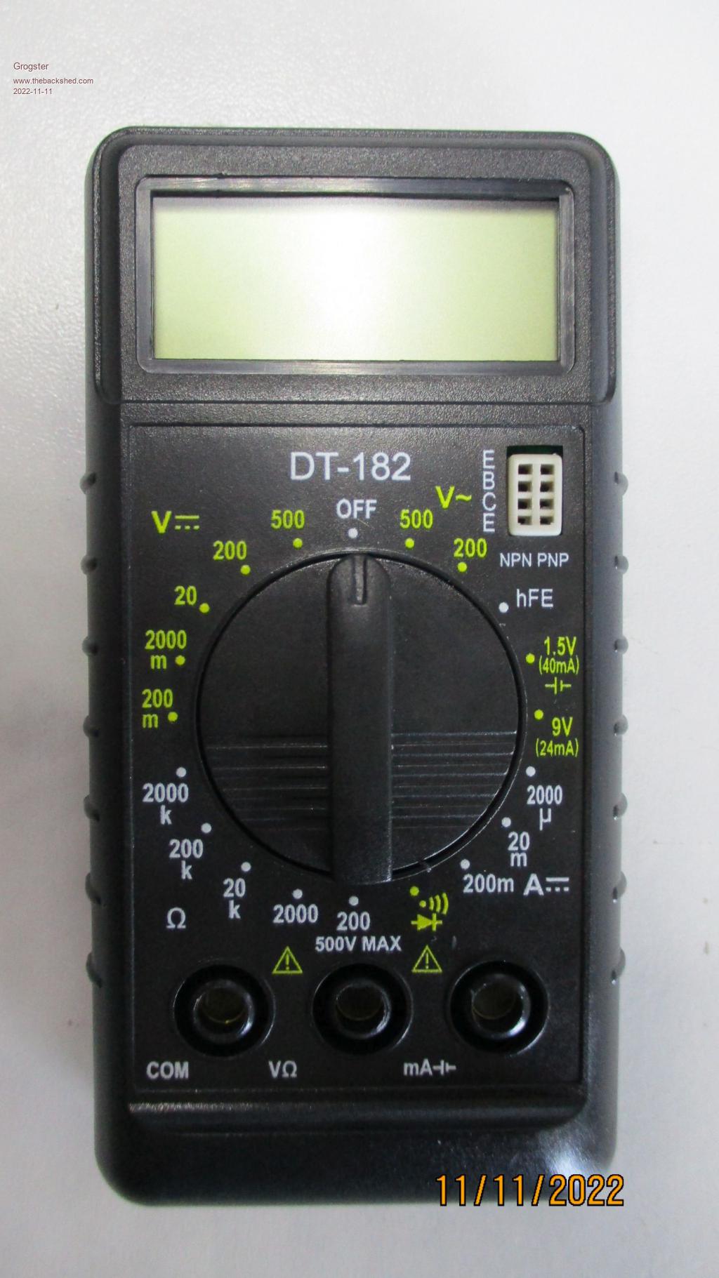

Purely out of interest, I bought a couple of these.
Less then two bucks a piece , but they work OK, surprisingly.  Comes with el-cheap-o leads and printed instruction sheet, inside a bubble-bag.

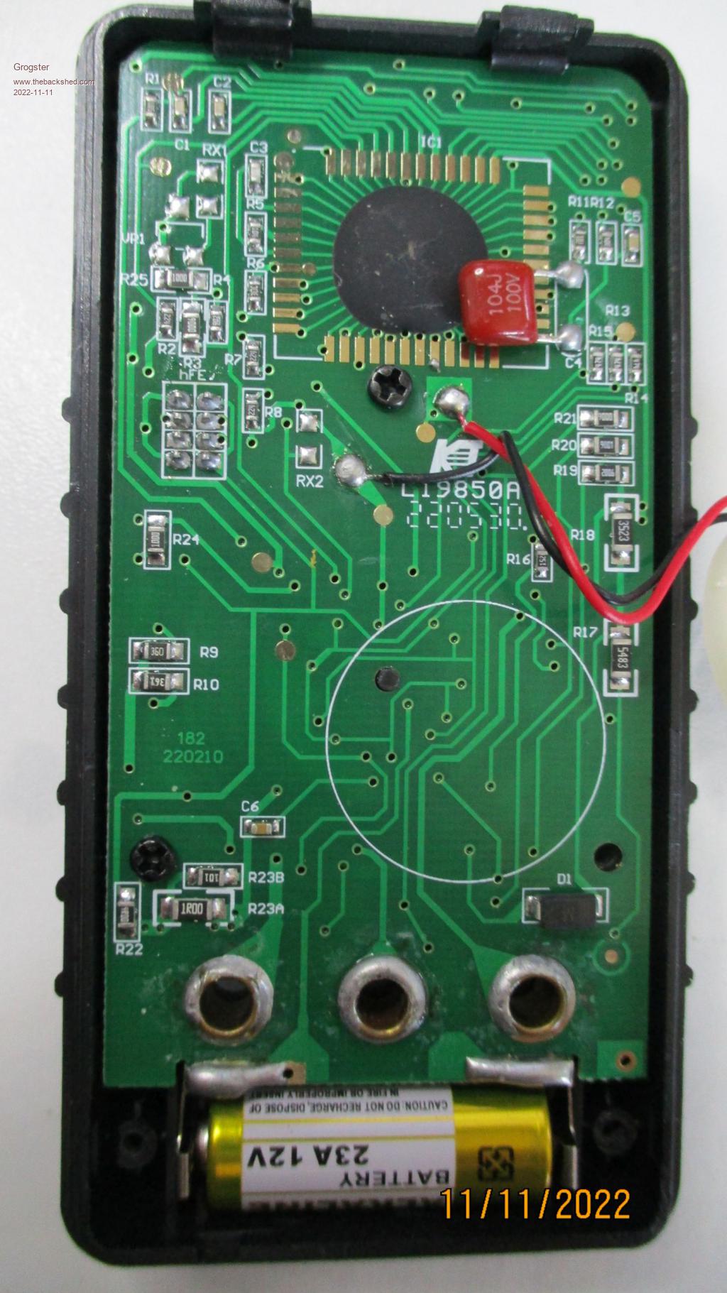

I would NOT use these things for any high-voltage probing, but for low-voltage stuff, they would seem to be ideal for throwing in the glove-box of your car, or keeping them around almost as a disposable meter - use it till it craps out or the battery goes flat, then bin it.  Looking at its guts(photos below), I can see that the PCB trace spacing is not really up to HV spec, so stay away from the 200v and 500v(eek!) ranges, but everything else LV should be fine.  I'd trust them up to around 50v I think.
They read very accurately on voltage, and current is within a few mA on the 200mA scale - very useable for two bucks!!!
I did tempt fate - carefully - by jamming the probes into a 230v wall-outlet, and switching on.  Not touching the leads or the meter, but it did correctly read the AC outlet voltage, so they seem to be accurate enough despite being so incredibly cheap.

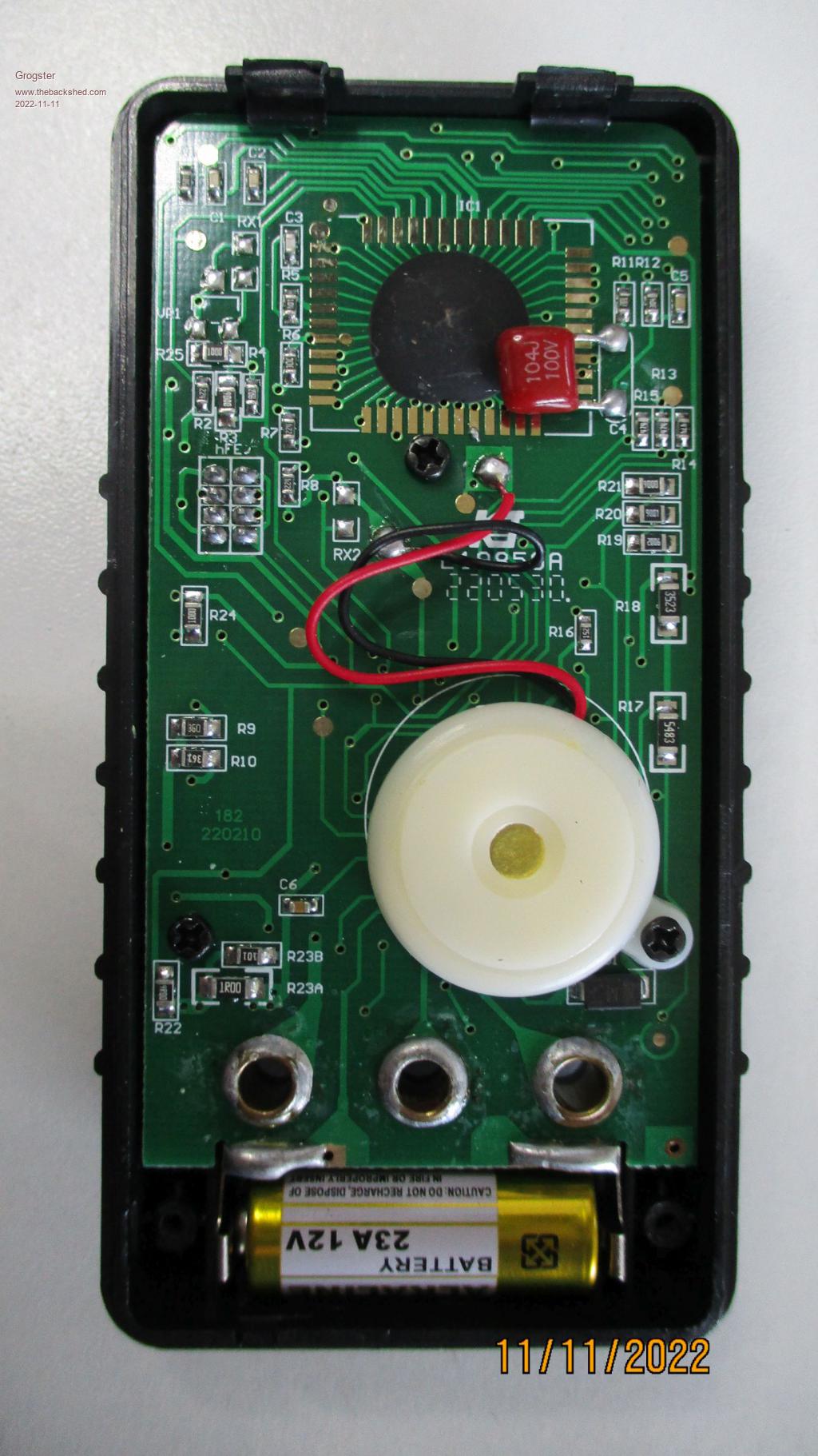

They even have a piezo inside for continuity measurements, and they only beep when the resistance is less then about 20 Ohms, which is good.  Many a cheap meter will beep so long as there is a circuit between the probes, even a high-resistance one.
They are small - fit inside your hand, but the LCD display is big so they are easy to read.  Dimensions are 184 x 103 x 25mm/7.24 x 4.06 x 0.98in.

I hope the probe leads have to be in the current measuring configuration to be able to use the 1.5v and 9v battery testing functions.
Posts: 9975
Posted: 02:26am 11 Nov 2022
Just looked at that, and yes - you have to have the red lead in the current hole, then you touch the probes to the battery.  With my test 9v battery, I got a reading of 24, which equates to a good battery under a simple load-test according to the very basic manual.

That looks terrifying. It has no input protections (zero, nothing, nadda, zilch) and would be a risk to life if used with mains voltages or on a valve amp etc. Best place for it is the garbage so no-one ever mistakenly uses it for high voltage

That's by no means the most horrible cheap meter I've seen. I suspect it'll handle 100V easily (and regularly) as the tracks aren't all that bad IMHO. Well, they aren't if the PCB material and solder mask are reasonable. The leads on these things are always horrid and should usually be binned immediately. The complete lack of fusing will lead to a short working life, methinks, and automatically precludes all use on mains circuits.

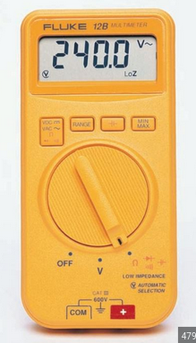

one of my favourite multimeters (albeit neither cheap nor obtainable) is the fluke 12b:
rob   :-)

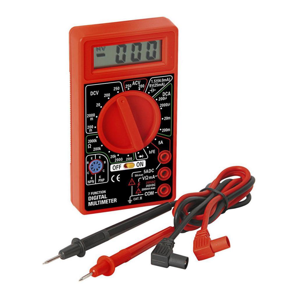

Not much better or worse than this one that they often give out for free.
Harbor Freight
