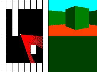

First make it work, then make it effizient
by following the YouTube Tutorial   step by step, i translated the C /openGL Code
to MM Basic and tested it on a 378000 kHz Pico Vga.
Speed on the Pico is ok but I am sure that there is much to optimise
also tested on MMBasic4W
as in the Video, there is no collition detection by now.
'Raycast.bas by Martin Herhaus
'MMBasic translation from
'https://youtu.be/gYRrGTC7GtA by 3DSage

dont get lost
Edited 2022-11-16 23:52 by Martin H.

  gadgetjack said  Very good work. I have to play around with this.
maybee you ll do the next wolfenstein Clone

updated Version
(here in Windows)
'Raycast Engine MMBasic translated from

Very nice Martin, a bit slow on the poor old PicoMite but nothing a bout of optimisation, or failing that, a CSUB wouldn't fix I'm sure.
I have once again taken the liberty to use your code to continue ironing out some issues with my controller library:
CMM2 version with support for Wii Nunchuk, Classic, and on the DX version Atari joystick and NES gamepad; note that the latter requires an adapter to cross-over the power pin:
       raycast-cmm2.zip
PicoMiteVGA version with support for Atari joystick and NES gamepad using the PicoGAME Port A pins:
       raycast-pmvga.zip

Hi Tom,
sadly, I haven't found any instructions on the web yet how to compile CSubs for the Pico (Environment, compiler etc).
But maybe, I Find a faster Algorhitm to do the casts in Basic.
On the Website, where the BubbleDemo came from, is a Algorhytm with a different approach.
For Now, you'll get it a little faster by lowering the resolution
change in the  drawRays3D sub
than it does less Scans per Frame
For r=0 To 119
to
For r=0 To 63
and  the Part
Box xstp,(hv>>1)-LineO,1+hh/60,Lineh,,wcl,wcl
Inc xstp,hh/60
to
Box xstp,(hv>>1)-LineO,1+hh/32,Lineh,,wcl,wcl
Inc xstp,hh/32
PS: Your Version works well, as long as I use Port A for Atari or NES Controller

Hi  Led,
in my working Version I didn't use the Distance Function anymore, cause every Function call is timeconsuming .. So i do the pythagoras calculation within the Program, two times
Also, to speed things up I try to use "IF THEN" in the Loop only if it is really necessary.
That's why some adventurous lines come out like :
Inc ra,P2I*(Ra<0)-P2I*(ra>P2I)
to keep it in the Range of 2 Pi
Another way to optimize would be to rewrite the Algorythm to use degrees instead of radius, so I can convert the "floating Point Calculations" to Integers.
the best CSub would have to contain the whole Raycast Function like
Cast PX,PY,PA,Casts
that returnes the "casts" number of distances in an Array which can be read in the Draw_Wall Sub. :-)
As you can see, there is still a lot to optimize.
I have to go to the office now, but I'll think of something.
Cheers,
Mart!n

Hi Tom
today I found the Time to speed it up as much as I could.
so for PicoMite VGA its ..ok (5-10 fps)
raycast-pmvga.zip
but it does not run in MMbasic4W (dosnt know the "ON" Command.
and keyboard Controll does'nt work on both Pico and Windows.
Edited 2022-11-26 01:35 by Martin H.
