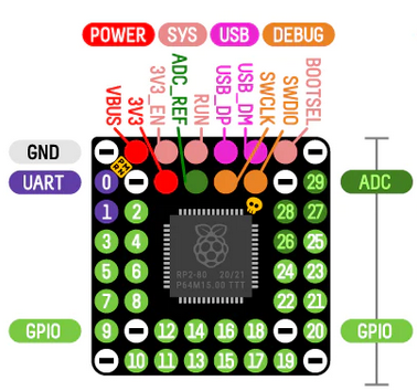

Really liking this....Great job, Pete
Not able to prove it for myself, atm and I'm 99.9% sure that I have this right but if I limit my read to 8 bits, I can do this?:
print #2, chr$(port(gp2,8))+chr$(port(gp10,4));

Yeah, I have 12 inputs and I need to efficiently send their states to another MCU where the individual bits are evaluated. No problems re: printing, etc.

Check the manual
  Quote  I/O pins used must be numbered consecutively and any I/O
pin that is invalid or not configured as an input will cause an error.
You need to split the function up more to miss the GND pins
e.g. print #2,BIN2STR$(UINT16,PORT(gp2,4,gp6,4,gp10,4));
will send a 16-bit binary value and all the pins will be read simultaneously
Edited 2022-12-01 20:03 by matherp
Tinine
Joined: 30/03/2016
Posts: 1646
Posted: 10:33am 01 Dec 2022
  matherp said  Check the manual
Whoa! I had no idea that a GND would be evaluated. Glad I asked. Thanks Pete

As with all the MMBasic family the I/O is based on the physical pin no.s and in the case of the PicoMite this uses the Pico as the reference layout. To make things easier for the user I have allowed the use of GP no.s but these are immediately translated internally to the physical pin no.
Tinine's port function could equally be PORT(4,4,9,4,14,4). PORT(4,6) will give the error "Invalid input pin" as it tries to use GND pin 8 as an input
