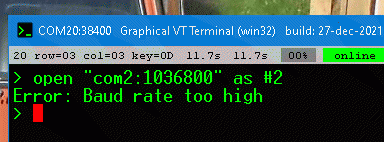

Is there a specific valid increment because I get complaints >921_600.

I get an expected error message:
"1036800 is invalid (valid is 24)" - is definitely an odd error message, and I suspect it is a bug of some sort.
What are you using?
170 MM2 chip?
MM+ chip?
ARMmite?
PicoMite or PicoMite VGA?
My message came from a MM2 on a 170 chip, simply as I happened to be writing something at the time I checked the forums, and everything was all hooked up, so I was able to do a quick spontaneous test.

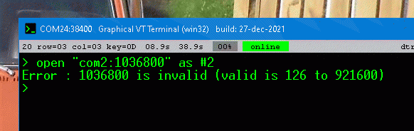

EDIT: Just tried this on a PicoMite, and I get the following error report:
So, it looks like you've maxed out the com port speed.
Edited 2022-12-13 22:35 by Grogster

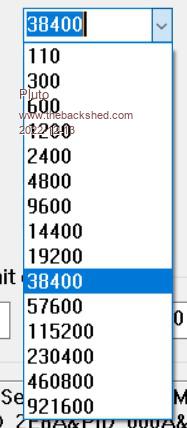

Pluto
Joined: 09/06/2017
Location: Finland
Posts: 411
Posted: 12:44pm 13 Dec 2022
These are the standard speeds.

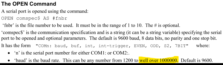

Posted: 12:52pm 13 Dec 2022
User manual: "Well over 1000000"

was a little bit surprised in Grogster's screen grab, minimum baud is 126... 110 was common on a lot of older stuff, and while I agree it isn't common now, I would have imagined compatibility just because...  Tinkerers beware!

Posts: 9975
Posted: 02:20am 14 Dec 2022
I've never needed anything faster then 115k2, but that is just me.
It is impressive that you can get upwards of 1Mb UARTS on an interpreted BASIC.
The "well over 1000000" thing is probably a hangover from the Micromite Plus range of devices based on the PIC32MX470 series chipset.  They have hardware UART's that were easily capable of that, but the lesser-spec chips I think could not go as fast with their UART's.  The 2040 chip used in the PicoMite I THINK has hardware UART's, but they obviously can't run QUITE as fast as the MM+ chip UART's.  In any event, 921k6 is all you're gonna get.
