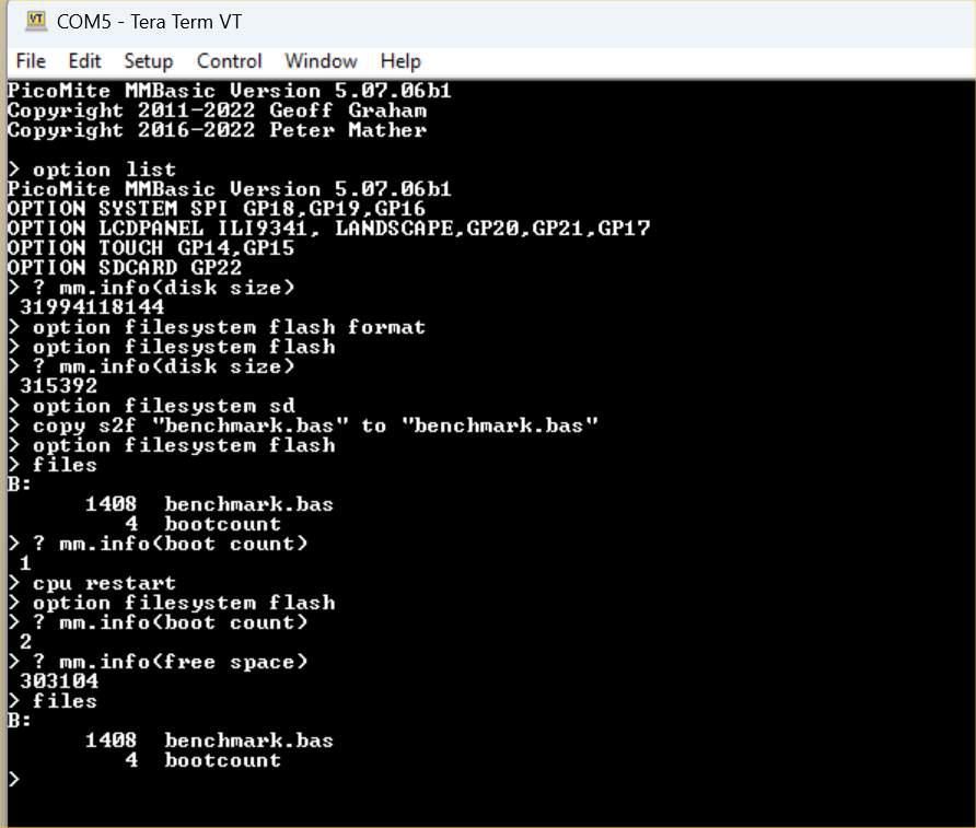

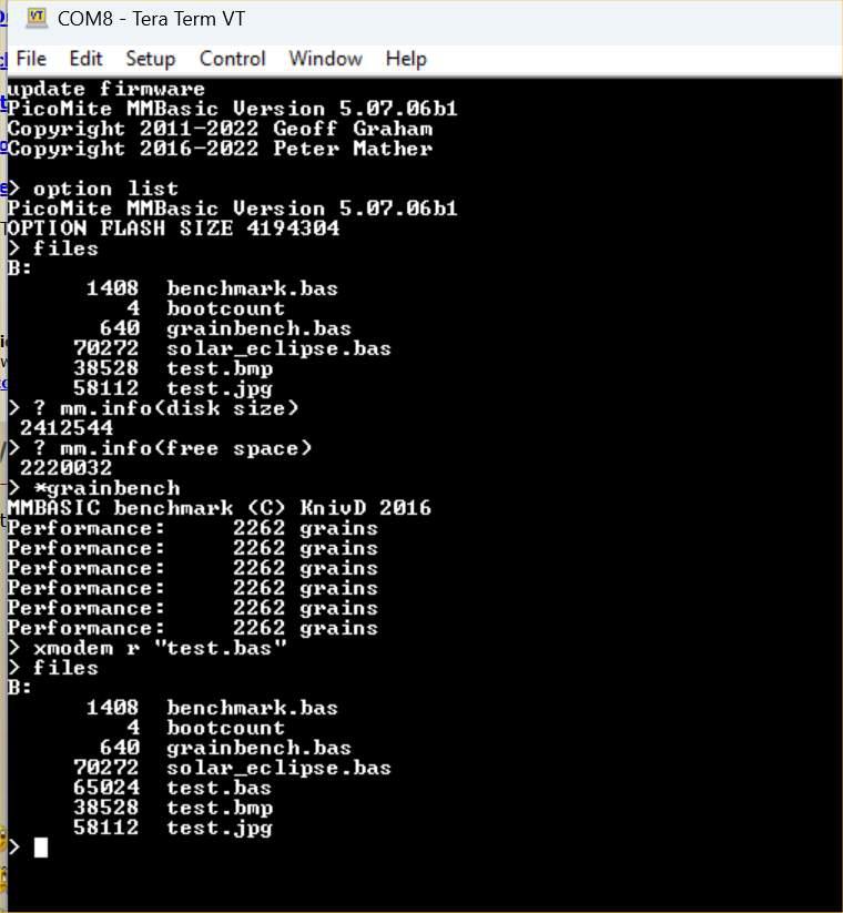

Posts: 11882
Posted: 08:49am 16 Dec 2022
Support for flash chips > 2M
Copy to from SD to Flash

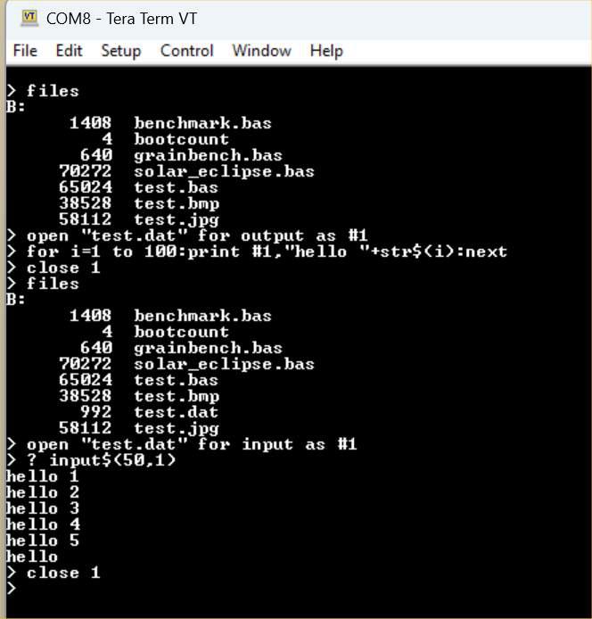

Can you write data files to the flash, not just programs?

Great Peter!
Just to clarify the "Flash".
-I suppose this is the "onboard" flash memory chip, which is 2M on the "standard" green modules shown in the PicoMite User Manual. The new features will not be possible for these modules?
-Do I have to buy an other module with e.g. 4M flash onboard or is it possible to add an "external" flash to the "standard" green modules for enabling the new features?
Thanks!
Posts: 11882
Posted: 11:04am 16 Dec 2022
Standard Pico 2Mb
Posts: 4398
Posted: 11:10am 16 Dec 2022
Impressive - can you tell us some other things that can't be done with the PicoMite so that we can look forward to enjoying them in the future ?
Joking aside, I thought the first post said it required flash > 2M ?
Is this compatible with storing programs in flash slots ?
Is access meaningfully faster than to the SDCard ? - I'm thinking in the context of using it to support the virtual memory that a full (128K) version of Z-MIM requires on the PicoMite.

Posted: 11:17am 16 Dec 2022
  Quote   I thought the first post said it required flash > 2M ?
No: just includes support for >2Mb as well as the standard
  Quote  Is access meaningfully faster than to the SDCard ?
Based on simple test of just loading a file - yes much faster - remember the flash chip is memory mapped for read
Current status is pretty much everything is working but only a single file allowed open at any one time (Same as ArmmiteL4) and single directory. That is the next (BIG) change (multiple files definite but directories not sure). Also not happy with the selection of the filesystem but can't use another command as no slots free. Finally haven't decided whether to allow file prefixes (A:, b:) also a very big change
