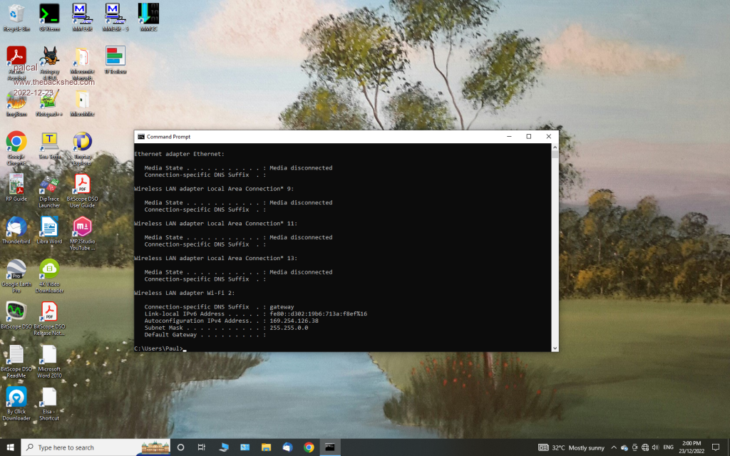

A storm blewup my router, got new router and connected OK. Configured the laptop and works OK. Workshop computer will not connect to the internet. Iget a message 'Invalid IP configuration'. I have tred everything  HERE
Still no go, any ideas.

The laptop is connected and works OK. The workshop computer connects to the wifi but has no internet and when I trouble shoot I get the message 'Invalid IP configuration'
Running ipcofig gives me

Your adapter has ended up with a default address meaning it couldn't find the modem.
From a command prompt
IPCONFIG /RELEASE
IPCONFIG /RENEW
you might need to add ALL to either or both the above commands.

The 169.xx.xx.xx address is a windows default IP address when no IP address was provided by a dhcp server.

is a temporary IP address because when your PC asked for one from a DHCP server (normally an element of your router) it didn't get an answer. It's called APIPA
