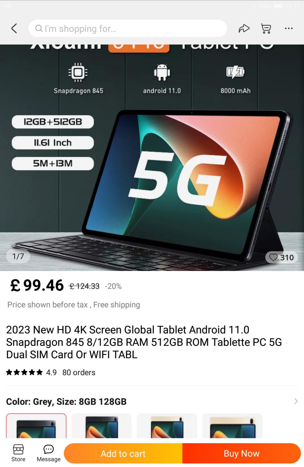

Craig: How many affordable Android devices have 4k displays?

Posted: 04:24pm 14 Jan 2023
"Affordable" is subjective but in terms of value for money:
Craig
Posts: 4335
Posted: 05:04pm 14 Jan 2023
For those who actually do want a 4K tablet, and don't mind that supplier, it's probably good value.
With MMBasic - or any Basic - for me, crickets.
(I paid less for a great, used, laptop, with a much nicer keyboard, far bigger HDD, and I don't care about 4K, but that may be your idea of crickets.)

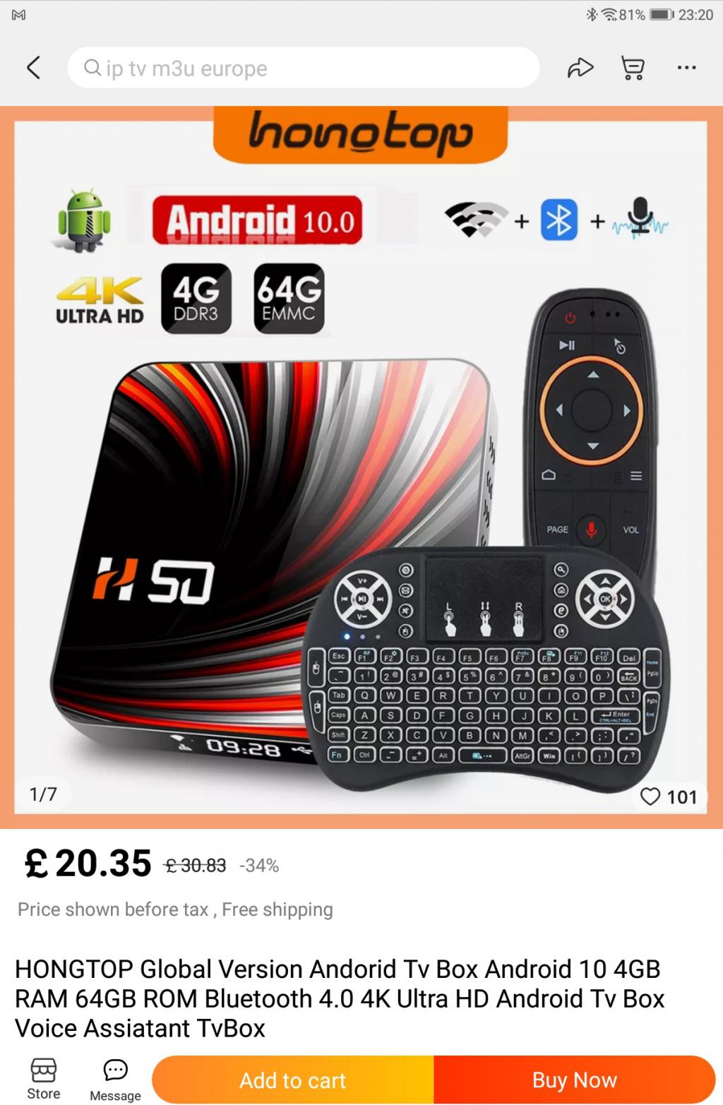

Posted: 11:30pm 14 Jan 2023
Man, I just couldn't imagine life with no imagination/creative-thinking and no desire to explore new possibilities.
The Mites don't accomplish much without add-ons.
Might just grab one of these and see if I can make it talk to the Mite.

Posted: 11:46pm 14 Jan 2023
Keep us posted, Craig.
I'd be interested in seeing what people could come up with with a 4K mediaplayer type thing like that, interfaced to MMBASIC in some way.  I still think it would be kinda tricky even to interface to a mediaplayer.  The android laptop you linked to might have more possibilities, but at the end of the day, if you really want 4K, then buy a 4K device such as the mediaplayer or photo-frame thing, forget MMBASIC and job done.
As for MMBASIC supporting 4K, Peter has confirmed that will never happen simply cos of hardware limitations more then anything else, but even if you COULD get a chip with that kind of capability - such as HDMI or DisplayPort out or something, it would be heckspensive and there would seem to be little point when you can buy android tablets or laptop things as linked to here, that CAN do that natively, so why not just use those directly for your display purposes.  4K is rather beyond the capabilities of MMBASIC, and outside of the scope of what MMBASIC is supposed to be I think it is fair to say.
My humble 2c/2p only.
I'm always interested and amazed at how MMBASIC can be bent to do things thought impossible, but we might have found the ultimate brick-wall in the 4K idea though!
