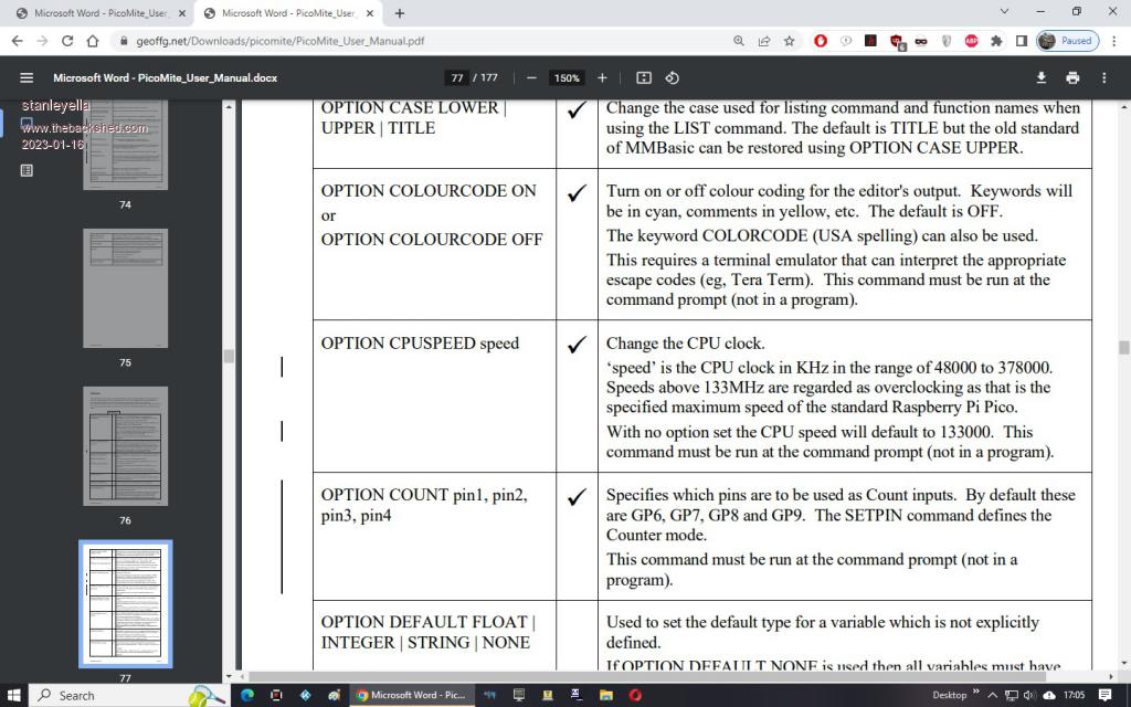

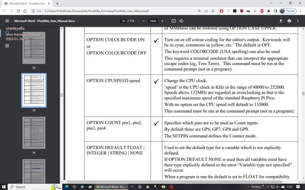

Which of these options in the old and new manuals is correct please?

Why wouldn't it be the newer manual?

Maybe to do with 378000?

EeJit,
The user manual is updated. So expect the new user manual to be correct. There where also software changes that only exist in the new V50706 software. And not in the previous V50704 software. Many functions and commands are added and adapted.
Please understand that the user manuals for VGA picomite and normal picomite are different. With respect to CPUspeed the VGA version runs default at 126MHz, where as the normal picomite runs 133MHz. (The different CPU speed is related to the VGA timing.) But there are amy more differences.
P.S. with 378MHz clock speed many picomites will work. But we have seen at lease 1 unit that does not. The 252MHz is to be used in doubt.
