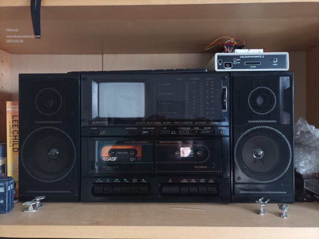

Nimue
Joined: 06/08/2020
Posts: 427
Posted: 04:50pm 07 Feb 2023
  Nimue said
  matherp said  If you want a comparison, the Colour Maximite 2 has a true H/W random number generator which is used whenever you call RND
Of course!!
Time to fire it up....
How much geek in one photo ;-)
N
Posts: 8911
Posted: 04:59pm 07 Feb 2023
That is true geekery in all its beauty. :)
I've not seen one of those Matsui boxes for ages.

Nimue
Joined: 06/08/2020
Posts: 427
Posted: 05:28pm 07 Feb 2023
  Mixtel90 said  That is true geekery in all its beauty. :)
Not shown but the RF in is a great match for my Zeddy and Speccy.  B&W of course!
Another rabbit hole for the weeked.
N
Posts: 8911
Posted: 05:35pm 07 Feb 2023
I really approve of the little Tardis too. :)
