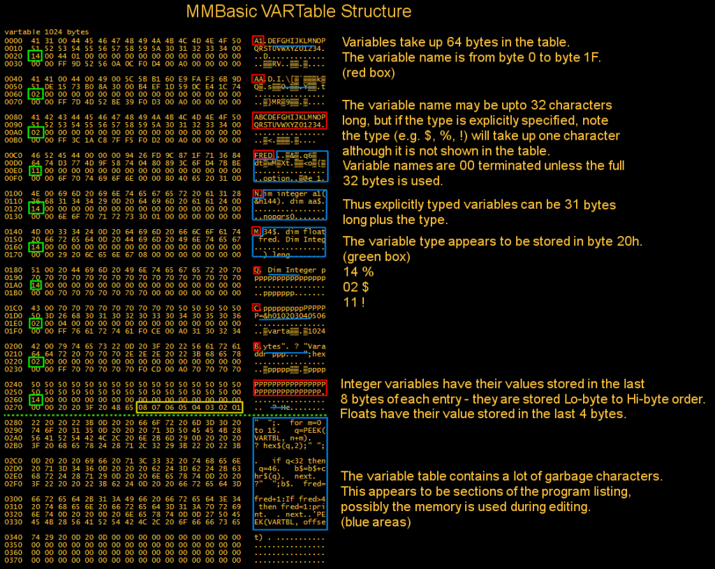

Posted: 09:26pm 11 Feb 2023
Whereas there is plenty of scope for diffent datatypes, the core code of MMBasic would likely require extensive reworking to accomodate them and the various type checks fr mismatches etc.
From my PEEKings back in November; a variable entry in VARTABLE  is 64 bytes long, integer values only occupy 8 of those bytes (yellow box). Floats occupy four bytes. A theoretical single byte datatype would possibly occupy one but the entry for the variable would still be 64 bytes long. No memory saving would be realised if the same scheme were followed.
The following is far from complete and possibly inaccurate. One question remains: How do I tell where the end of the vartable is (i.e. how many variables have been definded?)

  CaptainBoing said  One question remains: How do I tell where the end of the vartable is (i.e. how many variables have been definded?)
I don't think you can on that particular implementation (Micromite?) as it doesn't look like it sanitises unused blocks. Even if it did the gaps created by local variables being deallocated or the use of ERASE would make it difficult. For the same reason you can't just add a variable with a distinctive name and look for it in the table. Internally the 'mites I'm familiar with maintain a variable counter but it isn't exposed to BASIC.
EDIT: If you were desperate you could on startup POKE the table full of 0xFF (maybe just the type bytes), the maximum size of the table for this purpose could be looked up in the source code. You could then determine the maximum allocated index by scanning through the table looking for a 0xFF type byte, that would do it wouldn't it?

Posted: 11:21am 12 Feb 2023
Sorry, yes, this is on MicroMites. As I understand it the method of handling variables on the Pi and CMM2 are different so that might not apply.
I have gone through the source code (as well as I can - not a C programmer) and cannot see any way to detect the end of the table so a counter would explain that. I generally search 2048 bytes in 64 byte chunks which allows for 32 variables - probably about right for most tasks. I might add I am probably making a mountain out of a molehill here as I don't often piddle about with this stuff in my code.
"Cleaning" the table is a nice idea but we are back to the "how far can I go?" problem - don't want to trample on stack or anything important... trial n error I guess.

Posts: 4369
Posted: 12:27pm 12 Feb 2023
  CaptainBoing said  "Cleaning" the table is a nice idea but we are back to the "how far can I go?" problem - don't want to trample on stack or anything important... trial n error I guess.
Right, I've had another look and I think the MMBasic firmware for the MX170 (and possibly all of Geoff's ports other than MMBasic for DOS) use a dynamically growing variable table (unlike MMB4L and those of Peter's ports that I am familiar with). I think the C global "Memory.c#VarTableTop would need exposing to MMBasic for this strategy to work ... you may as well ask for Geoff to add BOUND to the MX170 firmware - if it can take it without cracking.
From the source:
/* all memory allocation (except for the heap) is made by m_alloc()
  memory layout used by MMBasic:
         |--------------------|    <<<   This is the end of the RAM allocated to MMBasic (defined as RAMEND)
         |    MMBasic Heap    |
         |    (grows down)    |
         |--------------------|   <<<   VarTableTop
         |   Variable Table   |
         |     (grows up)     |
         |--------------------|   <<<   vartbl
                                        This is the start of the RAM allocated to MMBasic (defined as RAMBASE)
  m_alloc(type, size) is called when the program is running and whenever the variable table needs to be expanded
  Separately calls are made to GetMemory() and FreeMemory() to allocate or free space on the heap (which grows downward
  towards the variable table).  While the program is running an out of memory situation will occur when the space between
  the heap (growing downwards) and the variable table (growing up) reaches zero.

Captain: Walking through the variable table is not really feasible for a BASIC program.  As you noted, the overall size of the table is not exposed and anyway, this will dynamically change as variables are added and more RAM is allocated to the table (so zeroing the table will not work).  As you might have discovered from the source, the variable table grows upwards while general RAM usage (arrays, buffers, etc) grows down.  Unallocated RAM is in the middle.  EDIT: Tom beat me to it!
