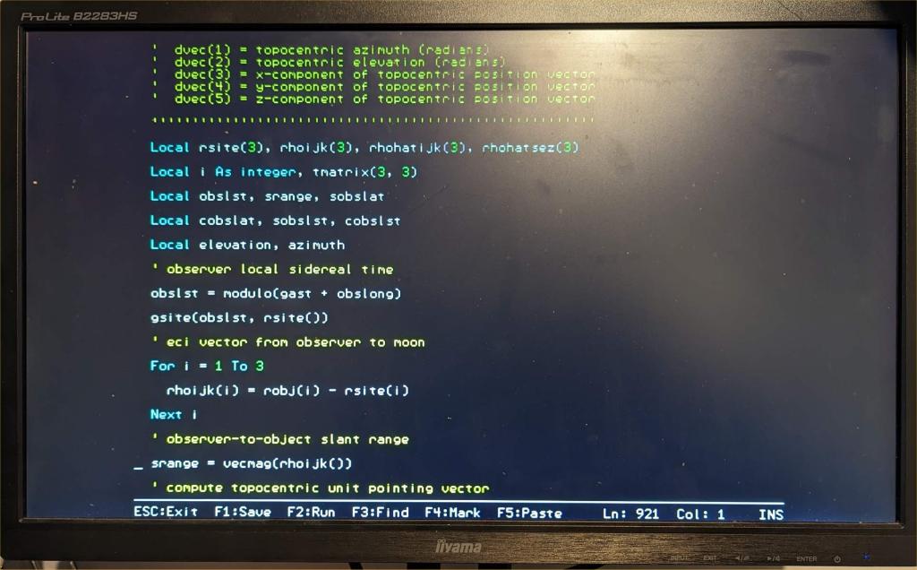

I just discovered the TILE command to give colors in the monochrome mode (mode 1). It lets you set the foreground and background color in a series of 16 by 16 pixels rectangles 40 across and 30 down. That size aligns with font 3.
Would it be possible to have the TILE size adjustable? If the tile size could be set to the size of font1 (8 x 12), we could have colored text at 640 by 480.

I can't see that happening, to be quite honest. The tile size limit is probably set by the maximum space available in the frame buffer.

Tiles are currently 16x16 pixels, hence 40x30 on a 640x480 VGA screen.
There is 1 font that aligns. But it is 16x16, large characters.

The frame buffer is always 38.4k
You have to think of the VGA display as a graphic display, even though it may be displaying text. You can't PRINT to it, you draw the text with the TEXT command. In that respect the number of characters is irrelevant, it's the number of pixels that counts.
The frame buffer can be split in two ways:
Mode 1 is 640x480. Each pixel is on or off, so 38.4k
Mode 2 is 320x240x4 colour bits = 38.4k again.
I think tile mode probably uses pixel doubling horizontally. That would use 19.2k of the frame buffer for the pixels and anything up to 19.2k to store the colour info, but it would also prevent the possibility of variable size tiles. Pixel doubling would be fast and relatively easy to accomplish - there's not a lot of processing overhead involved.
For 8x12 tiles you can't use horizontal pixel doubling (unless you reduce the number of horizontal tiles to 40 and use half the screen width) so you can't gain frame buffer space to put any colour info into.
