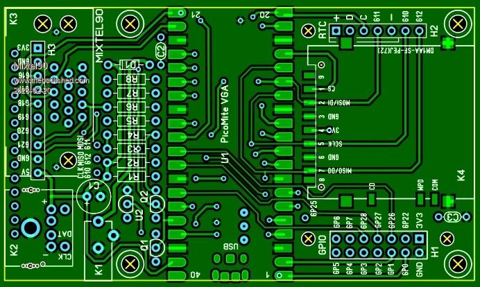

Posts: 8904
Posted: 06:07pm 17 Feb 2023
Look at the first post of the thread, Stan. He's using Design #2, which is almost certainly on a pre-drilled PCB. That module simply won't fit mechanically. If he was using the Design #2 *circuit* on a breadboard then you'd be right - those little modules can be very convenient. I've used them on PCBs several times as well as on breadboards.

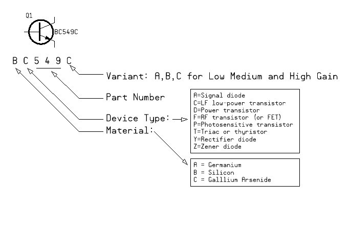

Europe adopted a standard for semiconductor parts naming that was based on a pre-existing Philips standard used for vacuum tubes. These parts became known as the Pro Electron/EECAdesignation which was created in the mid 1960s. It used a much more informative prefix and suffix than the JEDEC standard used (JEDEC is where 1N for diodes and 2N for BJTs came from). Here is an example:
Interestingly, pretty much every 'BC' part has a flipped layout from JEDEC pinouts, and Japanese parts also tend to have a different layout than JEDEC parts.  It's almost as if they are forcing you to *use their replacement parts* if your PCB was designed for them in the first place.
