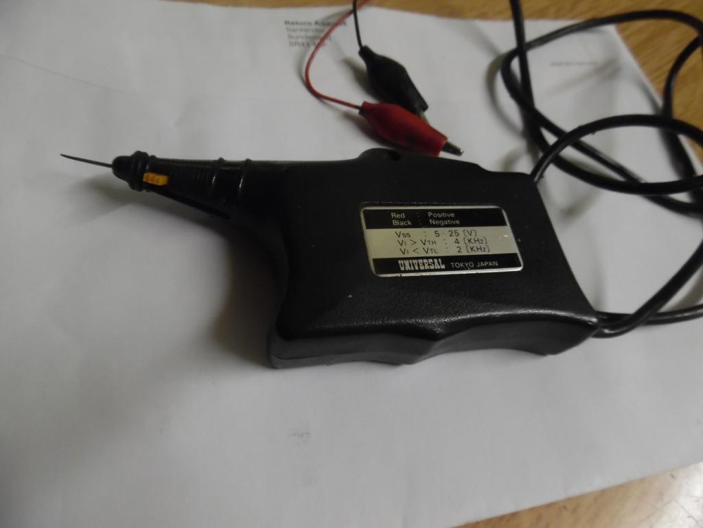

Posts: 2807
Posted: 07:24pm 17 Feb 2023
Mick - nostalgia from working in a video games factory that made universal games into cabinets. a free tool for analysing logic.
You were supposed to fix faulty ram with these.

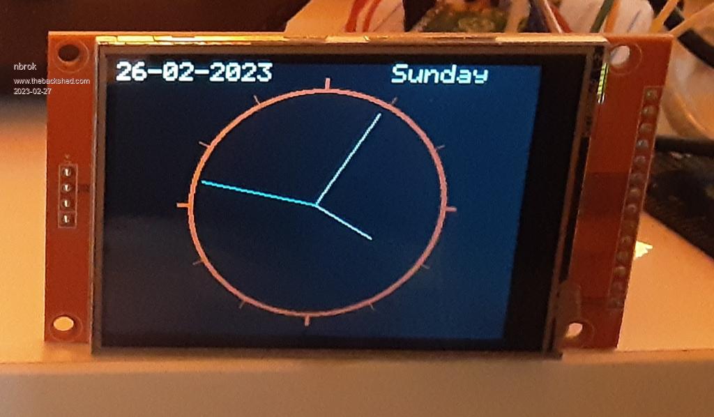

Posted: 03:01pm 26 Feb 2023
Here the latest version of my clock: In upper left corner the date is displayed and
on the right corner de day of the week:
