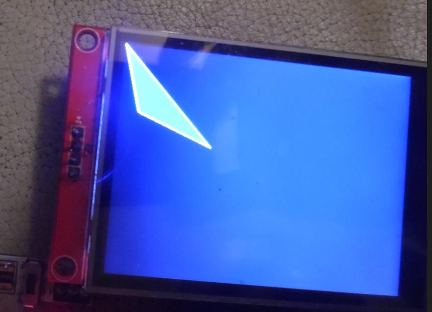

Posts: 2807
Posted: 04:27pm 22 Feb 2023
This works for me. yellow triangle filled blue. ili9341.

Posts: 2807
Posted: 06:08pm 22 Feb 2023
triangle 0,0,100,100,20,70,rgb(255,255,0),rgb(0,0,255) also works fine.
It is yellow triangle filled blue on black background.. camera not good.

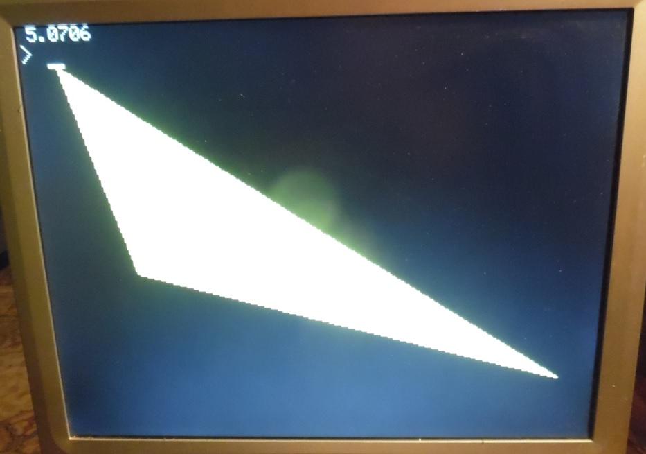

Posts: 2807
Posted: 08:40pm 22 Feb 2023
Ah, problemo with vga, it fills with triangle shape colour ie yellow in this,not blue.
mode 2
OPTION BASE 0        ' 0 based arrays
option DEFAULT INTEGER
OPTION EXPLICIT
const WH =RGB(255,  255,  255) 'WHITE
const YE =RGB(255,  255,    0) 'YELLOW
const LI =RGB(255,  128,  255) 'LILAC
const BR =RGB(255,  128,    0) 'BROWN
const FU =RGB(255,  64,   255) 'FUCHSIA
const RU =RGB(255,  64,     0) 'RUST
const MA =RGB(255,  0,    255) 'MAGENTA
const RE =RGB(255,  0,      0) 'RED
const CY =RGB(0,    255,  255) 'CYAN
const GR =RGB(0,    255,    0) 'GREEN
const CE =RGB(0,    128,  255) 'CERULEAN
const MI =RGB(0,    128,    0) 'MIDGREEN
const CO =RGB(0,    64,   255) 'COBALT
const MY =RGB(0,    64,     0) 'MYRTLE
const BL =RGB(0,    0,    255) 'BLUE
const Bk =RGB(0,    0,      0) 'BLACK
const Gy =RGB(128,  128,  128) 'GREY
const Lg =RGB(210,  210,  210) 'LITEGREY
const Og =RGB(255,  165,    0) 'ORANGE
const PK =RGB(255,  160,  171) 'PINK
const Gd =RGB(255,  215,    0) 'GOLD
const SA =RGB(250,  128,  114) 'SALMON
const BE =RGB(245,  245,  220) 'BEIGE
cls bk
print mm.ver
triangle 20,20,300,200,55,135,ye,bl
triangle 20,20,300,200,55,135,RGB(255,  255,    0),RGB(0,    0,    255)
