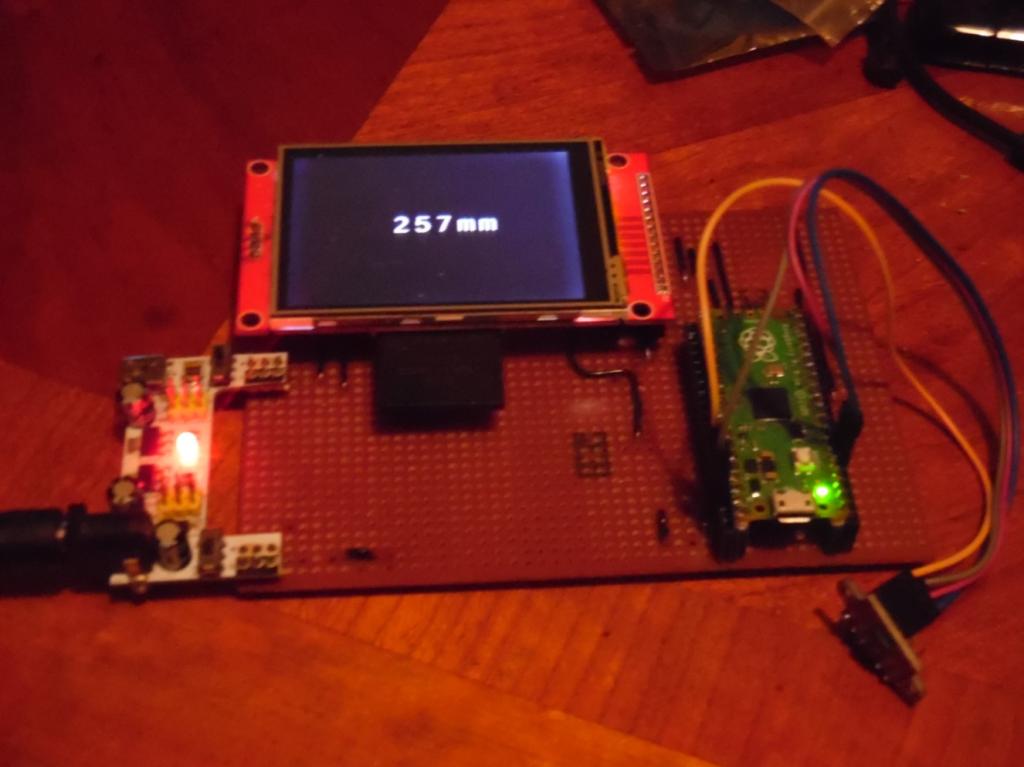

Dim d$
SetPin gp4,gp5,i2c
I2C open 100,1000
Const i2caddr=&H29
I2C write i2caddr,0,2,&H89,&H1
Font 5
Pause 200
CLS
getdistance
Pause 100
Sub getdistance
I2C write i2caddr,0,2,0,1
I2C write i2caddr,1,1,&H1E
I2C read i2caddr,0,2,d$
Text MM.HRes/2,MM.VRes/2, Str$(Str2bin(uint16,d$,BIG),3,0)+"mm",cm
'Print Str2bin(uint16,d$,BIG)
End Sub

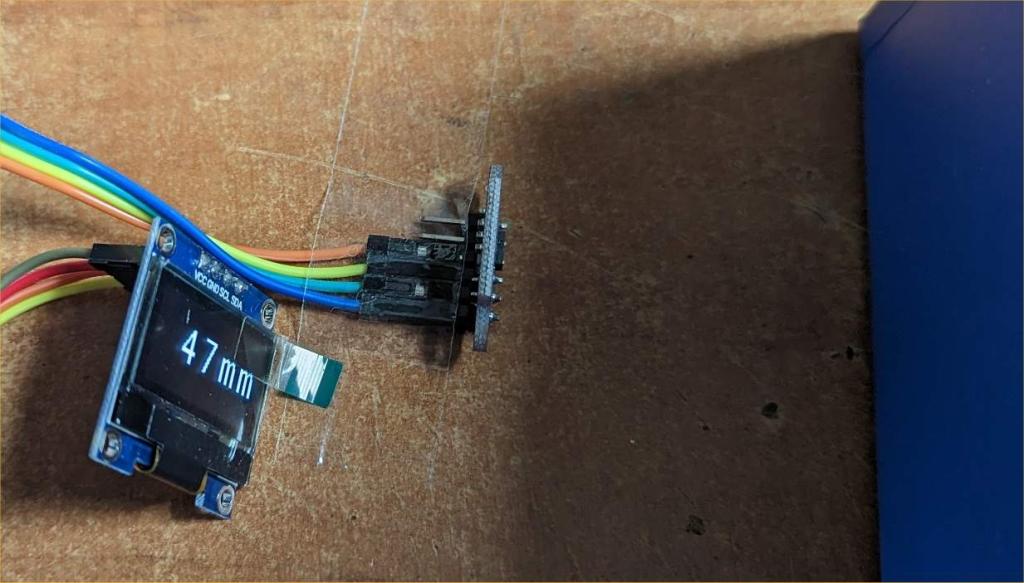

The vl53lox i2c address is &H52... Const i2caddr=&H29 ??
Text MM.HRes/2,MM.VRes/2, Str$(Str2bin(uint16,d$,BIG),3,0)+"mm",cm -- WOW!
Thanks for your time. It is not mmbasic's place to explain i2c or spi
but do you have to understand it to use it in that I just wired i2c and spi displays and they work?
Converting basics was never fun, bbc to locomotive to spectrum, I recently looked up the "Snake" game in basic. Which basic would be easiest to convert to mmbasic thoughts.
The manual has all the info for i2c but it's different to gcb, I'll have to understand it for other i2c devices that give info.
Studying bitbang i2c is interesting but the hardware i2c syntax I must figure.

Posts: 5927
Posted: 08:08pm 06 Mar 2023
Hi EEjit,
The miracle of the 52 and 29 is easily explained.
The first byte send after I2C start is the "chip address+ R/W bit".
This is build up as follows
bit 7...6...5...4...3...2...1...0
... A6..A5..A4..A3..A2..A1..A0..R/W
There is a 7 bit chip address (A6...A0) and a single R/W bit
MMBasic follows the I2C standard in using the 7 bit address
....0...1...0...1...0...0...1 = 0x29 (&h29)
In MMBasic the R/W is part of the I2C command (I2C READ and I2C WRITE)
Great Cow Basic uses the 8 bit address (includes the R/W bit in the address)
....0...1...0...1...0...0...1...0  = 0x52 (&h52)
That is all about the mysterie.... nothing fancy...

Posts: 2807
Posted: 11:40pm 06 Mar 2023
  matherp said  The manuals are trivial to understand with respect to I2C IFF you take the trouble to understand I2C first. It is not and cannot ever be the role of a MMBasic manual to explain the intricacies of I2C, SPI, UARTs etc
Appendix B of the manual has a great deal of information about using I2C including an example.
It took me less than 5 minutes to create the working, tested code above
Your code works on ili9341 lcd. Thanks. Seems you have the vl53lox. I like it more than ultrasonic range finders for robot avoid obstacles. Your code as an example in the manual for others maybe.
I added a space for the display or it left chars on the display
Text MM.HRes/2,MM.VRes/2, " "+Str$(Str2bin(uint16,d$,BIG),3,0)+"mm",cm
