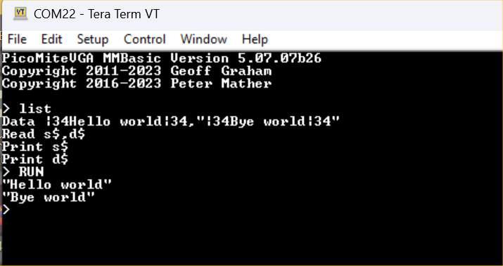

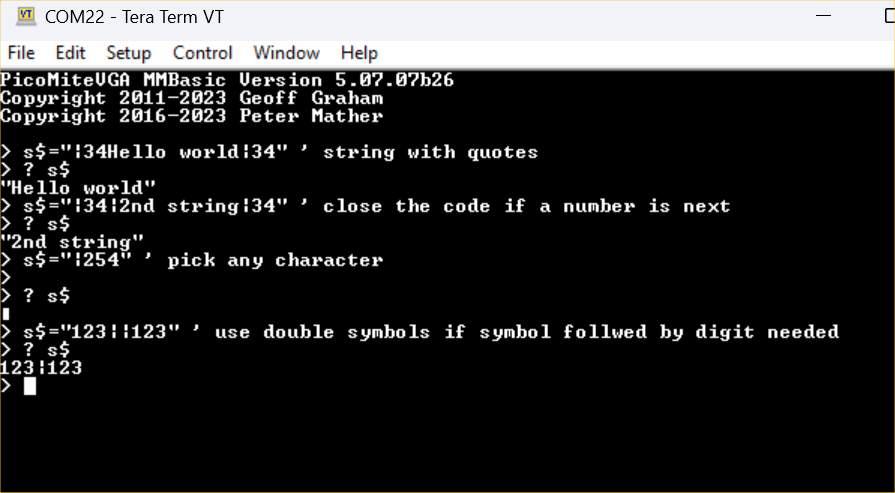

Building strings that need non-printing characters or double quotes requires use of the chr$ function and string addition and is somewhat clunky.
C uses the backslash character to do this
e.g.
char string[]="\"quoted string\"";
and there are variants of this like
\nnn where nnn is the number to be inserted e.g. \034 for a quote
In MMbasic we can't use the backslash as it is used in filesystem pathnames but the
| character (ascii 124) is unused in MMbasic syntax and very unlikely to be used in text strings
I've been playing with this
It can also be used in data statements
Thoughts - do I keep this in for the next beta?

Posts: 11499
Posted: 06:57pm 08 Mar 2023
  Quote  how would you distinguish between:
a$=chr$(2)+"345"
and
a$=chr$(23)+"45"
Already covered in the first image
chr$ can't be used in DATA statements. Also, concatenating strings will be much slower (factor of 3 in simple test)
  Quote  > timer=0:for i=1 to 1000: s$="|34Hello World|34":next:print timer
13.684
> timer=0:for i=1 to 1000: s$=chr$(34)+"Hello World"+chr$(34):next:print timer
40.375
Edited 2023-03-09 05:01 by matherp

Posts: 11499
Posted: 07:40pm 08 Mar 2023
Think I've found a way of using backslash which means it could be implemented in all versions. Does that change things?
Edited 2023-03-09 05:40 by matherp
Posts: 4369
Posted: 07:46pm 08 Mar 2023
  matherp said  Think I've found a way of using backslash which means it could be implemented in all versions. Does that change things?
In that case I think it is useful . Do you want to float how you can use backslash so that the hive-mind can see if you are digging a trap ?
Last year I was considering something similar for MMB4L but in the end abandoned the idea because it wasn't useful if only MMB4L supported it.
Posts: 11499
Posted: 07:56pm 08 Mar 2023
In the current code relating to file I/O there are lots of places where I allow slash or backslash but I always eventually convert them to slash.
All I've done is replace getCstring with getFstring for anything file related. The two are identical except that getFstring converts backslash to slash before anything else
I've tested it briefly and all works OK and Microsoft doesn't care if I use all forward slash and linux will be happy
Think I might impose backslash nnn with three digits. That way no termination is ever needed
Edited 2023-03-09 05:58 by matherp
