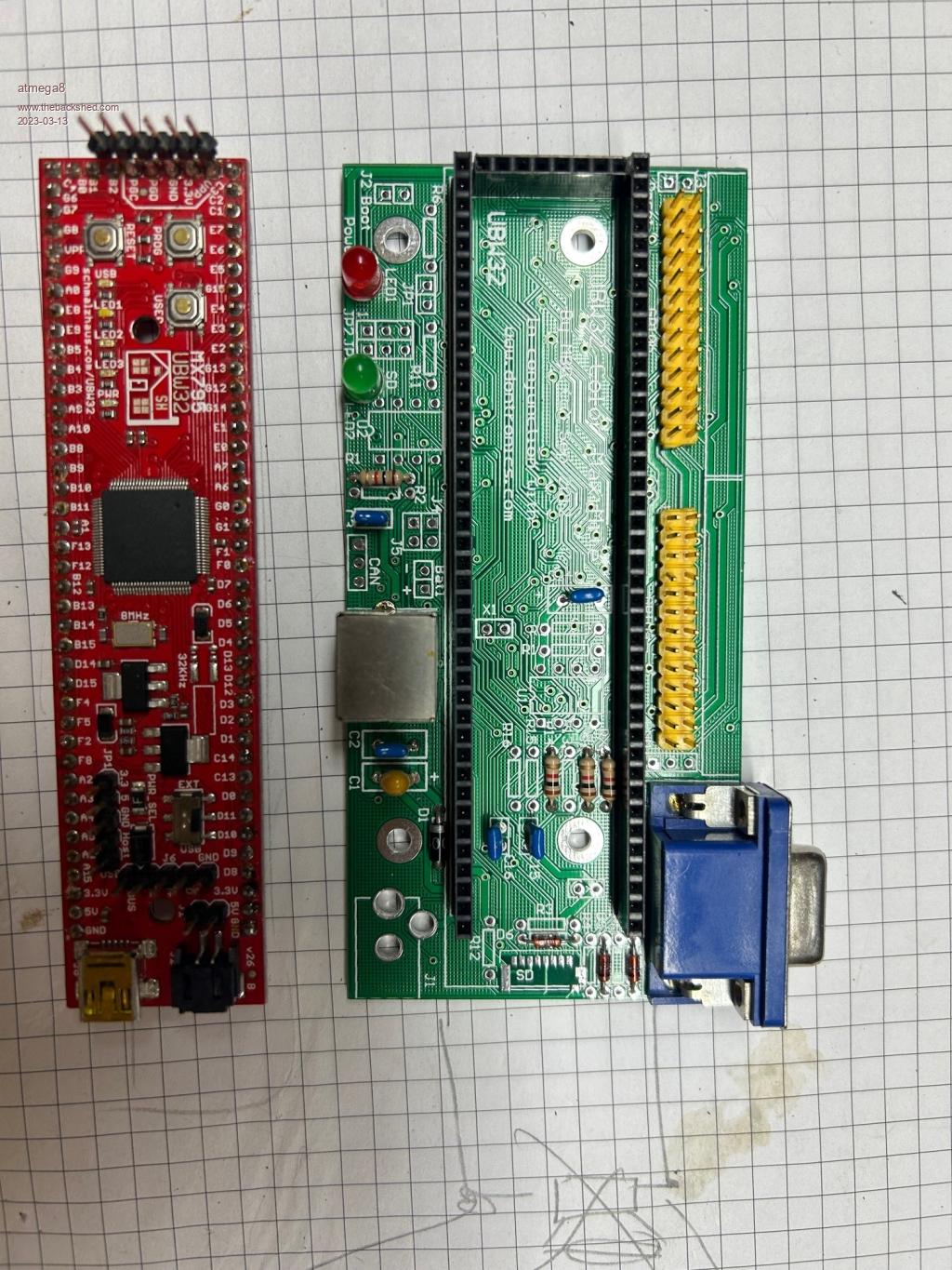

Hello,
i grabbed an UBW32 (Schmalzhaus) out of the box.
Bought it some years ago.
I would like to flash MMBASIC.
But if i plug it into my WIN11 PC not Device (serial, HID) shows up, of course i presssed the Prog Buttun during plug in the USB Cable.
Same happens under Linux, nothing with LSUSB/Dmesg.
The 4 LEDS (USB/LED1/LED2/LED3 are blinking and PWR is on.
There should be a bootloader on the Board, but....
Every Help/Idea is appreciated
THX in advance

I think you'll need to use picprog32 to load MMBasic firmware 1st time.

A 'new' UBW32 needs to be loaded with the original "firmware with bootloader" first.
After that, you can update to V4.5C using the serial port.
It's a long time since I did it but I do have a number of UBW32 boards all with MMBasic loaded successfully.

Hello,
trying to use the bootloader doesn’t work, because no Device was detected in Win 11 ( comx, HID).
Flashed UBW32 with Pickit 3 using the Hexfiles from schmalzhaus.com.
Same Result.
Flashed the whole Mmbasic HEX from Geoff.
Now comx, and Mmbasic 4.5c is up and running. Got comx and Terminal Access over USB is full working.

I also found this baseboard from ( Dontronics?) and now it’s Time to bring this Combo back to life.

With support from Brian Schmalz, THANK YOU BRIAN,
i was able to flash the bootloader.
And with the correct Bootloader
http://www.schmalzhaus.com/UBW32/FW/HIDBoot.X/dist/MX795/production/HIDBoot.X.production.hex
i can flash mmbasic or whatever i want.
