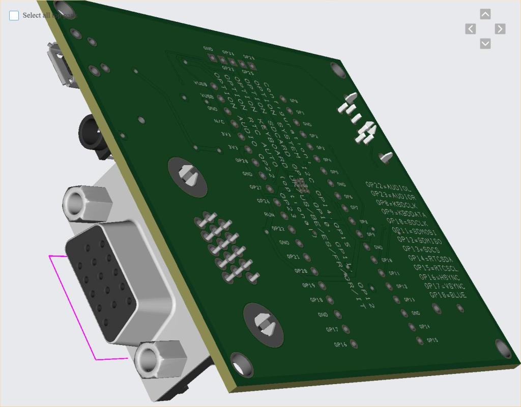

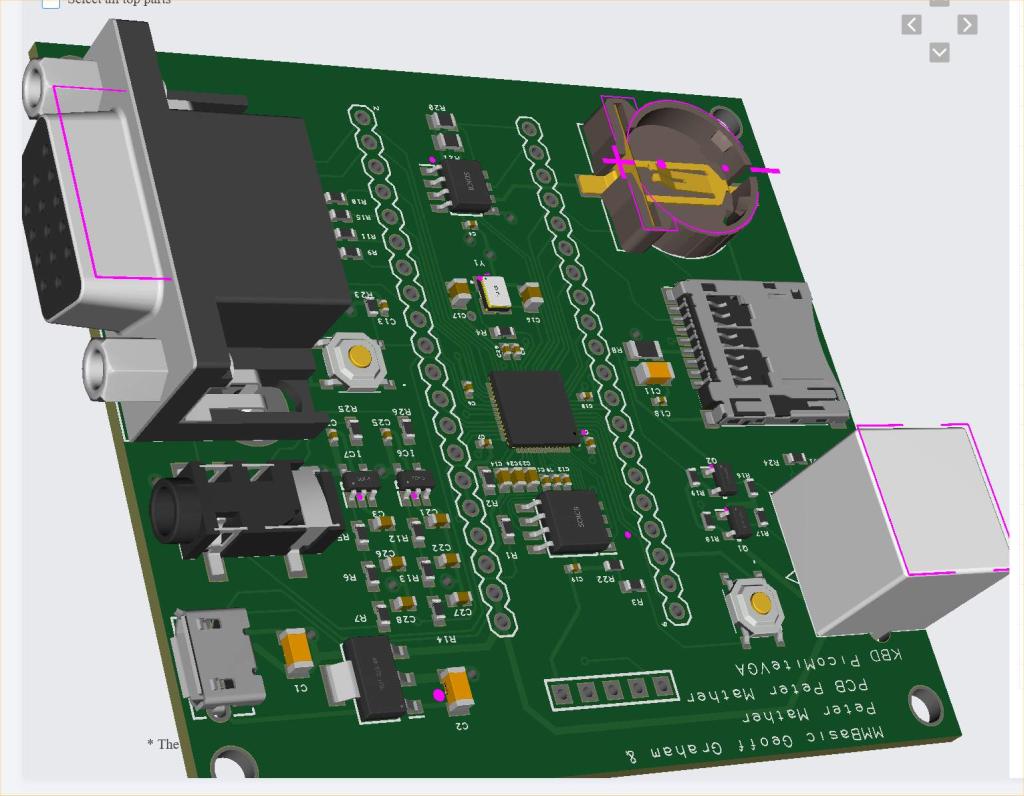

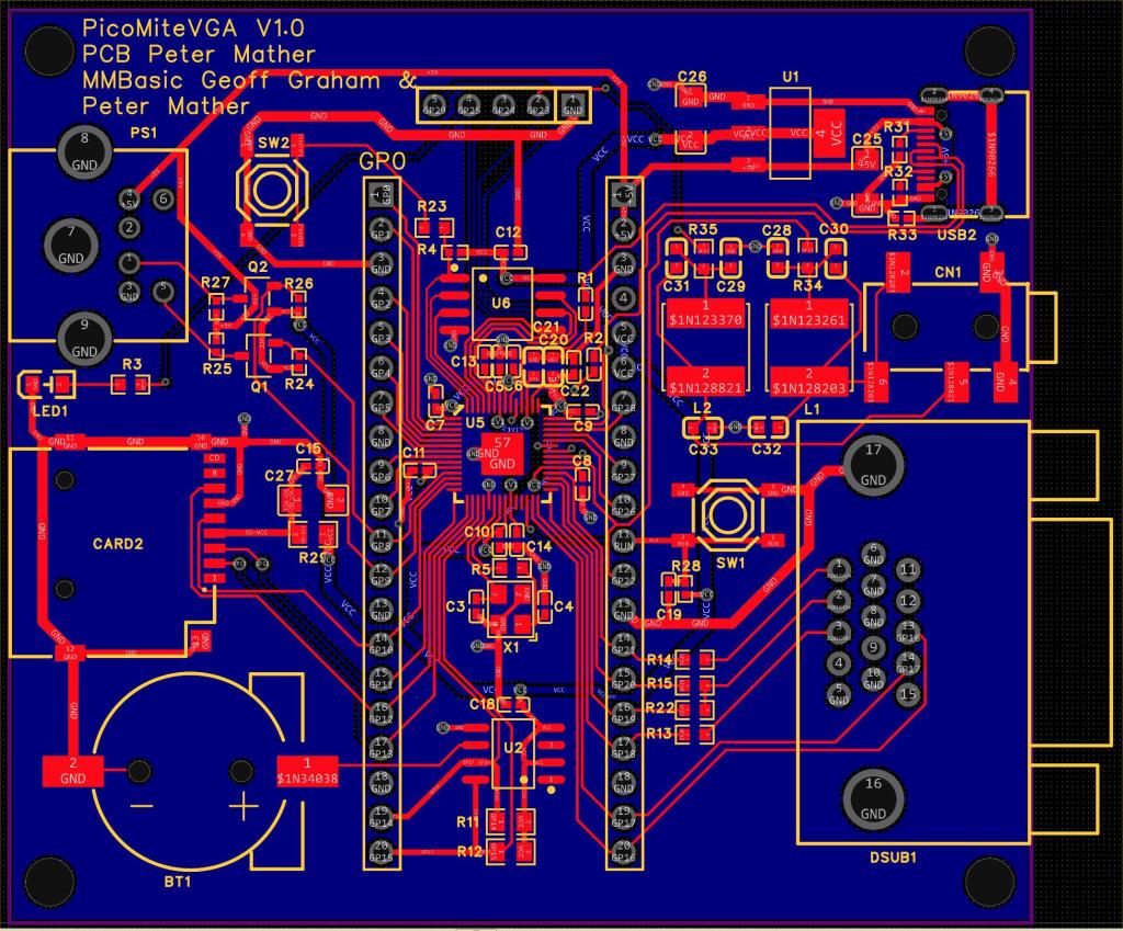

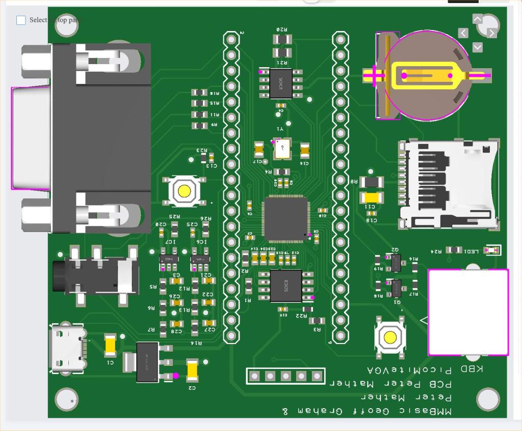

I have designed a ground up PicoMiteVGA including 16Mbyte Flash, DS1321 RTC, Volhout's high spec audio filter, micro-SD, PS2 etc. This doesn't use the Pico but is built from the RP2040. Every component used is available in quantity from JLC and the price above includes them soldering everything. i.e. for a complete ready-to-run board I have included a Pico footprint so you could add any of the Pico format modules (e.g. GPS) Unlike the Pico all pins are broken out. The majority of the price is in the "non-standard" components - the RTC itself is GBP3 and then things like the SDcard slot, PS2 connector, VGA connector all add to the price but, of course, this is true for a board you build yourself. If this seems interesting I will get a couple of board made to find and fix any errors. I love the JLC visualisation software - you can even see the through hole pins sticking through the board The board is 75x67mm double sided so cheap as chips but uses small components so I wouldn't recommend hand soldering Schematic FYI PicoMiteVGA - Project.pdf ![]() ![]() ![]() ![]() Edited 2023-03-16 05:01 by matherp |

Very nice looking Peter, likely worth a few boards to gauge interest. I think you intended NOT hand soldered (at least for me) but would be interesting to see prices as bare board, BB and all SMD in place and total assembled. Larry OOPs missed the wouldn't --too excited to view and missed the negation! Edited 2023-03-16 05:04 by okwatts |

That's very nice indeed. Is it a micro USB (which it looks like) for power or USB-C? Mick Zilog Inside! nascom.info for Nascom & Gemini Preliminary MMBasic docs & my PCB designs |
| phil99 Guru Joined: 11/02/2018 Location: AustraliaPosts: 3290 |
Not enough pins for USB-C |
| Mixtel90 Guru Joined: 05/10/2019 Location: United KingdomPosts: 8911 |
True, which is a pity. Mick Zilog Inside! nascom.info for Nascom & Gemini Preliminary MMBasic docs & my PCB designs |
| Volhout Guru Joined: 05/03/2018 Location: NetherlandsPosts: 5931 |

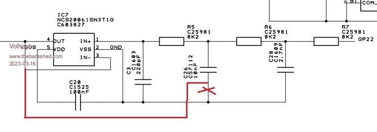

Peter, C22 and C26 should connect to the opamp outputs, not to ground. Volhout PicomiteVGA PETSCII ROBOTS |
| Hawk Senior Member Joined: 15/07/2021 Location: AustraliaPosts: 151 |
Peter, Your design looks good. The only downside that I can see is that once you put it into a case, the press buttons aren't accessible. I'm guessing that it adds to the cost to make the right-angle on the edge of the PCB. A good trick that many cheap TV boxes do is to put a right-angle boot switch at the end of the stereo socket so that it can be pushed by a toothpick as the unit is turned on. It's usually only required when re-flashing the firmware. Something to consider. From a purchasing perspective, would they need to be purchased via you in the UK, or could they be purchased directly from JLC PCB? Mike |

@Peter, This needs fixing (both channels L and R) ![]() Volhout Edited 2023-03-16 19:31 by Volhout PicomiteVGA PETSCII ROBOTS |
| matherp Guru Joined: 11/12/2012 Location: United KingdomPosts: 11512 |
Done thanks |

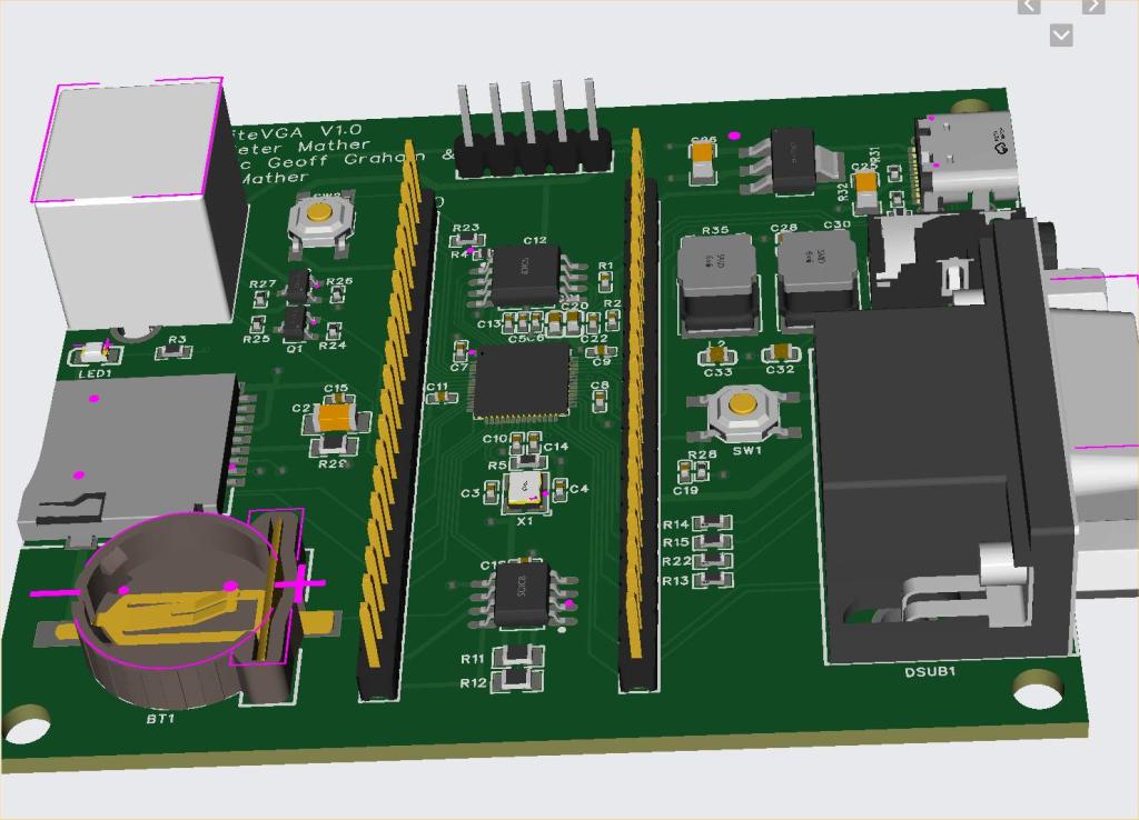

Minimum is 5xPCB with 2 built. PCB cost is so low as to be irrelevant GBP1.65 for 5 Note that if ordering yourself you can leave off any components you don't want and save cost. e.g. leave off the RTC and save GBP3 per board. This could include leaving off the VGA components if you just want a normal PicoMite with the SDcard/audio etc. all wired and guaranteed working. Just delete the unwanted components from the BOM and CPL (both excel files) As can be seen in the pics the PCB is organised in modular areas: VGA, audio, SD, PS2, RTC so it is easy to know what can be omitted for each function Edited 2023-03-16 20:57 by matherp |

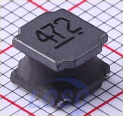

I've finalised the design having eventually found a nice SMT 4.7mH inductor. ![]() So I've sent the files off to JLC to build. Will report on receipt. Final spec is: RP2040 16Mbyte flash DS3231 RTC micro-SD slot PS2 I/F VGA output All pins broken out so 13 pins unused: 4 analog (GP26-GP29), and GP0 to GP7 + GP24 linear regulator USB-C Boot and reset switches All parts in stock at JLC so it can be built by them as a complete fully working unit My experience is that Volhout's inductor based filter is by far the best at removing the 44.1Khz and leaving a really nice clean output. ![]() ![]() VGAMite.pdf |
