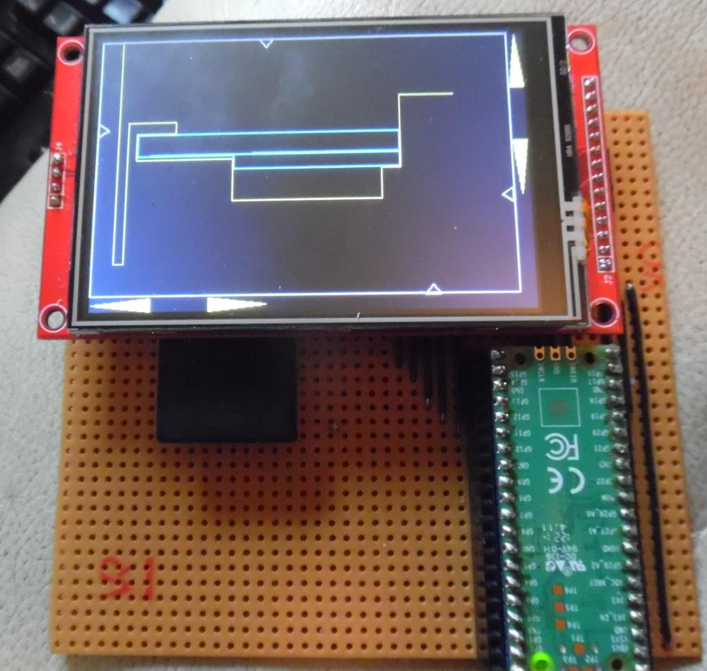

Hi, sorry to bother you but trying gui area on ili9488 and errors.
The ili9488 touch is calibrated and the touch test works.
I get this error message using gui area 1,2,395,64,14
[17] GUI area 1,2,395,64,14'left button   x  y   w  h
Error : No memory allocated for GUI controls
I spent time reading the latest non vga manual but can't see allocating gui memory.
Also would "loop until pixel px%,py%,1 >0" 'test if next pixel is not black work?
triangle 2,312,66,305,66,319,rgb(yellow),rgb(blue)
gui area 1,2,395,64,14'left button
triangle 192,312,130,305,130,319,rgb(yellow),rgb(blue)
gui area 2,192,395,64,14'right button
triangle 471,2,479,66,464,66,rgb(yellow),rgb(blue)
gui area 3,464,2,14,64'up button
triangle 471,192,479,130,464,130,rgb(yellow),rgb(blue)
gui area 4,464,192,14,64'down button
dim px%=400,py%=int(rnd*200)+60,pdx%=-1,pdy%=0
dim cx%=60,cy%=int(rnd*200)+60,cdx%=-1,cdy%=0

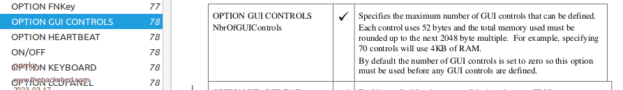

option gui controls 4 in teraterm seems to have sorted gui controls but says maximum is 3 not 4, so set option gui controls 10.
pixel (x,y) >0 worked. getting there. Now computer opponent... done it before

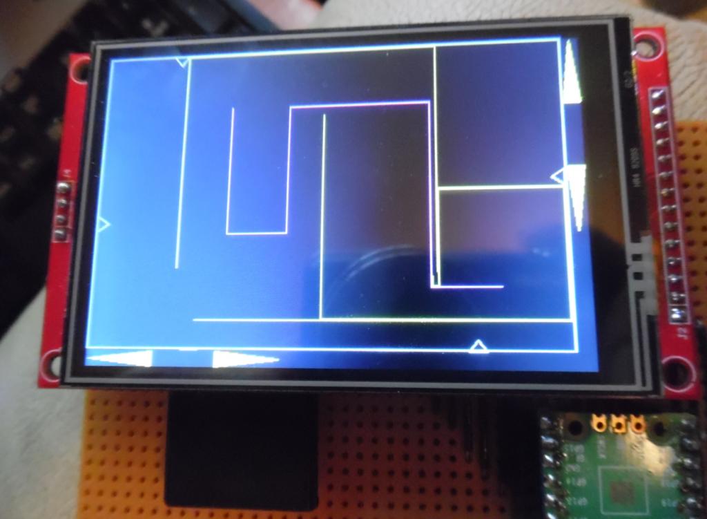

Posts: 2807
Posted: 04:05pm 17 Mar 2023
Hi Pual. the same error , it was a typo.
touch seems to like fingernails more than finger prints,
touch supposed to be NOT like a phone touch screen.
my first try on ili9488. maybe ili9341 better, will try

Posts: 9136
Posted: 05:04pm 17 Mar 2023
Touch on all the LCD displays supported by MMBasic is resistive, not capacitive. That's why you find it works better with fingernals than a finger. The bast way to use these displays is with a stylus (they are often supplied with one).
When you want to test an area of the screen it's better to test for the X and Y edges of that rather than for a point. The GUI commands take this into account.
Posts: 2807
Posted: 05:36pm 17 Mar 2023
Thanks all for helping me. I did read the manual but didn't get gui controls relevance
my simple tron

Just tried this using version b25 but it doesn't like GUI CONTROLS 4, it needs GUI CONTROLS 5 for some reason.
> run
[17] GUI area 1,1,295,64,16
> run
[23] GUI area 4,464,130,16,64
Error : 4 is invalid (valid is 1 to 3)

Posts: 9136
Posted: 11:47am 18 Mar 2023
As the amount of RAM used for GUI CONTROLS is rounded up to 2048 bytes anyway there's no point in specifying such low numbers. One control will require 2048 bytes as will 39 controls (39*52=2028 bytes). 40 controls will require 4096 bytes of RAM.
Posts: 2807
Posted: 02:57pm 18 Mar 2023
@paceman That's the error I got. I thought the gui controls started at zero but don't.
Mick- thanks for clearing that up.
It's in the manual but option gui controls isn't really mentioned and the number of gui controls could be better explained imho. pixel page 111 and 135,why not same page?
