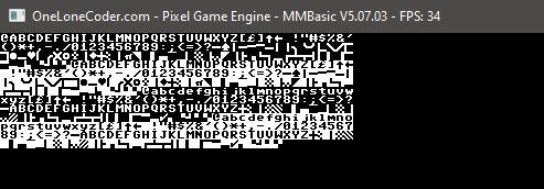

I  found the map of the petscii Charset
The Font in the Bin File seems to be in the Order of the "Screen Code"
0 to 255 first Charset (Upper Case and Graphic)
255 to . second Set (lower and Upper Case)
Chrs (128-255) and (384-511) are the inverted Version
confusng?
to visualise the Charset ... use this:
Cls: print @(0,200);
Open "c64.bin" For input As #1
x=0:y=0
C=0
 a$ = Input$(1, #1)
 Plot Asc(a$)
 c=c+1:If Not(C Mod 8) Then
 x=x+8: if x>319 then x=0:y=y+8
 end  if
 Loop Until Eof(#1)
Close #1
sub plot wert
v=1
for f=0 to 7
if wert and v then Pixel x+7-f,y+(c mod 8),rgb(white)
v=v+v
next
end sub
Edited 2023-03-19 05:19 by Martin H.

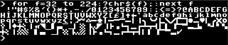

Martin H.
Joined: 04/06/2022
Posts: 1459
Posted: 02:17pm 19 Mar 2023
  Plasmamac said  Hi, i try to translate some old c64 basic games to the Picomite. Have anyone converted the c64 font to MMBasic?
Gtx
finaly I have transformed it
like this?
cls:?:?:font 9
for f=32 to 224
?chr$(f);:next f
font 1
' C64 Style Font (Martin H.)
' Font type    : 192 Characters
' Font size    : 8x8 pixels
DefineFont #9
C0200808

00000000 FFFFFF00 6C060301 00607078
End DefineFont
you can thank me later
Edited 2023-03-20 00:29 by Martin H.
