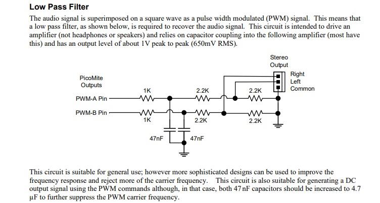

oops. My question -- is the vga sound low pass circuit only for vga or can it be used with non vgaa pico mite.
It's simpler than the non vga low pass circuit, no chokes.. just ordered 10 and just one preferred value cap.

It can be used for either.
I believe that once updated both manuals will show the same filter with the inductor/choke as that is a better quality filter.

The filter shown above will work, but the output shouldn't be fed into a modern amp with good speakers. You are ok with 32R headphones or most cheap desktop speakers (probably). It has pretty poor performance.
The 1k / 47nF combination extracts the audio from the PWM. The other two resistors merely halve the output level.

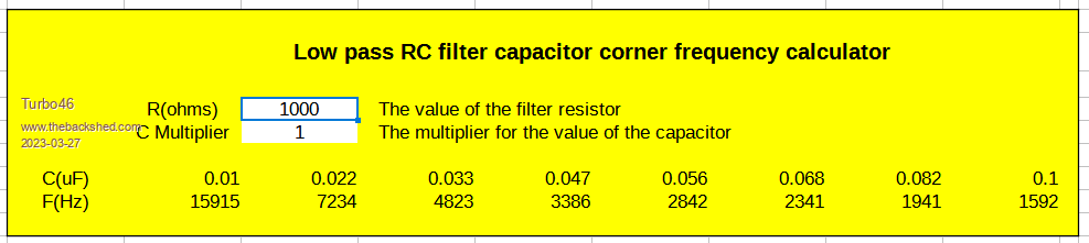

I would be happy with a two stage RC filter at around 5kHz. If anyone wants to roll their own RC low pass filter I have made a small spreadsheet that will help.
Starting with about 220R (about the min. load resistor that you would want to use) a capacitor to give you the frequency that you want. Adjust the resistor if needed. Add a second resistor in series with the original. Make it 10 times the value of the first one so that there will be little interaction. Then add a second capacitor to 0v 10 times smaller than the first one. Finish up with a resistor divider to give you the output voltage you desire. Done.
I found that 330R with 0.1uF followed by 3300R and 0.01uF will give me what I want. 4.8kHz.
If anyone wants a copy of the spreadsheet I can upload it here. It's in LibreOffice .ods format but I believe Excel can cope with that.

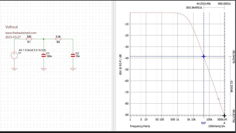

  Turbo46 said  I found that 330R with 0.1uF followed by 3300R and 0.01uF will give me what I want. 4.8kHz.
How much of the 40kHz / 44kHz is still there after that?

Residual 44kHz is 38dB down, so roughly 50mVpp
Note that your calculation for a single stage RC filter gives you -3dB at 4.6kHz. Chaining 2 stages will be -6dB at 4.6kHz (also shown in above graph).
Numbers say nothing. When you are happy with the result, that is what counts.
