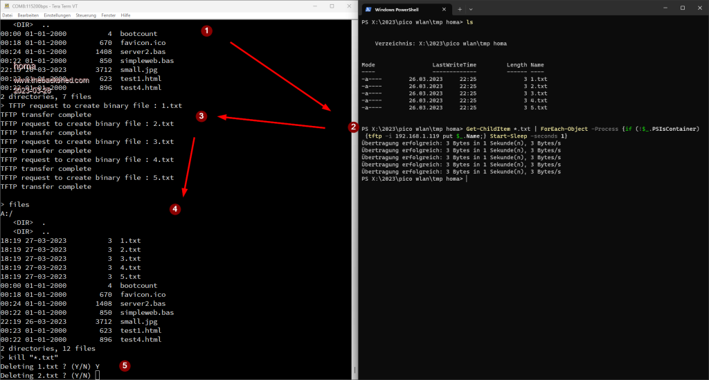

First of all @Peter many many thanks! This version looks very promising and could almost be the first beta. Long term stable, paramaters via POST work again. In between I was a bit sad because of the featuritis and the missing instability. But then came TFTP and that has surprised me then but very positive!
Unfortunately tftp which is included in Windows (after enabling it in the features) can't do wildcards. Also not in the CMD.
But in the Powershell I then searched the following command together (I'm a beginner in PS!):
Get-ChildItem *.txt | ForEach-Object -Process {if (!$_.PSIsContainer) {tftp -i 192.168.1.119 put $_.Name;} Start-Sleep -seconds 1}
The parameter -i is important (otherwise e.g. no images will work). With this command e.g. only .TXT or .HTML or also all (*.*) files from the current directory can be transferred to the PicoMite in one go! The pause is important so that the PicoMite can keep up with the requests.
Also the deletion on the PicoMite works with wildcards (e.g. kill "*.txt"). @Peter: Is it possible to pass a -y or -all here? Otherwise you have to confirm each file individually.
Since TFTP doesn't know DIR, you can't GET files with wildcards.
Cool is also that TFTP works if a basic program (e.g. the simple web server) is executed on the PicoMite. So files can be exchanged or added during operation.

  Quote  Also the deletion on the PicoMite works with wildcards (e.g. kill "*.txt"). @Peter: Is it possible to pass a -y or -all here?
Already there
KILL "*.txt",all
will prompt once only

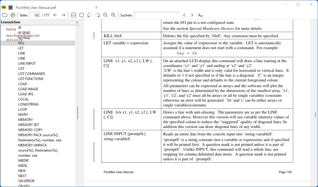

Hello Peter,
good to know. I had a look in the manual beforehand.
This should be added there. A task for @Geoff?!
page 19:
KILL fname$
Delete a file in the current directory on the current drive.
and see picture:
