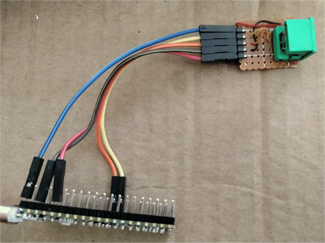

Posts: 3784
Posted: 06:36pm 07 Apr 2023
My first thought regarding 5V tolerance on the Pico was: This would be perfect for the keyboard.
But as I thought further about the circuit, I realized that the keyboard isn't driving either CLK or DATA to 5V--the high voltage is controlled by the pullups, and if the keyboard recognized 3V3 as high, as it should, then nothing is needed other than the 5V supply for the keyboard, and 10K pullups to 3V3.
I've now wired up a little module and connected it to a picomite with flying wires, and it works (at least for my HP PS/2 keyboard).
I don't know enough about the electronics of PS/2 keyboards to know when this might be a bad idea, so what are the circumstances which would cause it to fail to work or to harm the pico?
Edited 2023-04-08 04:37 by lizby

Posts: 8911
Posted: 07:25pm 07 Apr 2023
If the keyboard will work when powered from 3V3 then there's no problem as that's the highest voltage you can get. The problem comes with keyboards that need 5V to power them. In theory a slave device such as a keyboard doesn't have pullups so it's ok, but they don't all follow that rule and some have pullups to 5V internally.
Knowing what we know now, if you can guarantee that the keyboard can't give 5V (power it from the 5V supply via a diode so it actually has 4V4 for example) then it should, in theory, be ok. I'd much rather put some form of level shifting in though. I'd rather be safe than sorry.

Posts: 3784
Posted: 07:42pm 07 Apr 2023
  Volhout said  The pico is somewhat 5V tolerant.
Don't try it.
Sorry, but I already tried it, and thus far it is working.
The question I had was whether there was reason to believe that the keyboard would be applying 5V rather than acting in I2C mode and just pulling the line down from whatever voltage it got from the pullups on my little wired-up module (which in this case are 3V3).
It turns out that at least for this keyboard, it is pulling up the 5V being supplied from the PicoMite, and the voltage reading on these lines is 4V75.
I'll continue to work with this module. If it harms the PicoMite, I'll just consider that I've taken one for the team.
It may be that using no pullups and inline diodes plus, say, 10K resistor will also work and might be considered safer. I'll try that.
Is it the case that the Picomite is passive here, with the keyboard providing both CLK and DAT, or does the Picomite provide the clock with the keyboard asserting DAT within the clock frame?
Posts: 8911
Posted: 08:59pm 07 Apr 2023
In a *true* PS2 system both the computer and the keyboard use open-collector transistors and the computer has pullup resistors to 5V, which it also supplies to the keyboard. As I said before, some keyboards have pullups inside and some don't.
I had another think....
Note that the 5V "tolerance" only applies on *digital inputs*. You must still avoid putting more than 3V6 on any pins configured as outputs or on any ADC inputs. The PS2 clock signal is on a pin configured as a *digital output* so you are putting your PicoMite at risk if you have a pullup to anything above 3V6 - and that may or may not be inside the keyboard.
Edited 2023-04-08 07:00 by Mixtel90

Posts: 8911
Posted: 06:29am 08 Apr 2023
Hacking around with resistors, diodes etc, is fine, but you are only saving pennies to get a half-baked solution. Two cheap mosfets and four resistors (or a single 2-way level shifter module from China) fixes the whole problem for *any* PS2 keyboard. Maybe those pennies are important on a production run of 1000 boards, but not for one or two.
Posts: 3784
Posted: 12:20pm 08 Apr 2023
It's true--considering the apparent variety of PS/2 powering combinations, the 2-MOSFET plus 4 resistor combination looks like the most robust solution for a PCB. I'm sold.
