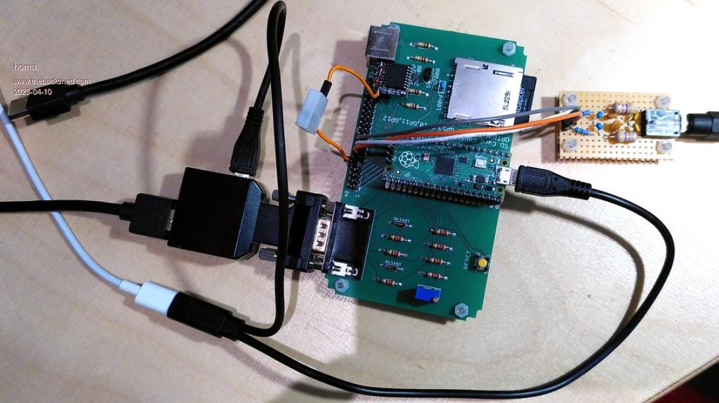

I bought this adapter here for 10 EUR from Amazon and the adapter works for me on the PicoMiteVGA with my monitor. https://www.amazon.de/dp/B08SR7FCRM However, since the adapter needs USB power, I connected the two devices with a USB-C Y-cable to USB-Micro ;-) ![]() |

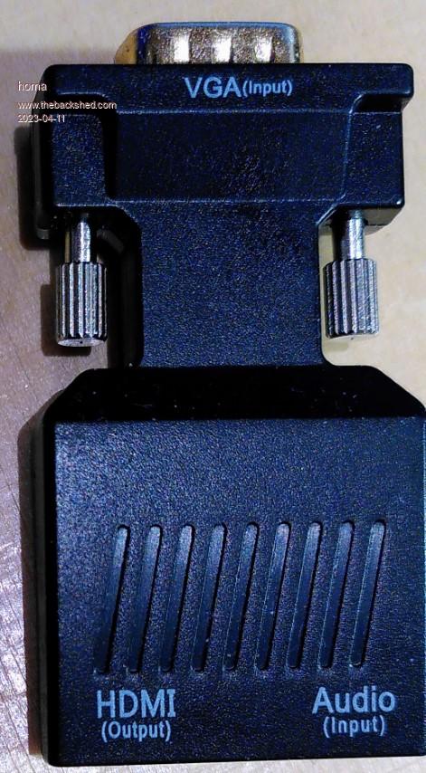

homa![]() Guru ![]() Joined: 05/11/2021 Location: GermanyPosts: 464 |
Yes the Amazon image is incorrect. But the delivered adapter has the correct labelling and an audio input! ;-) ![]() |

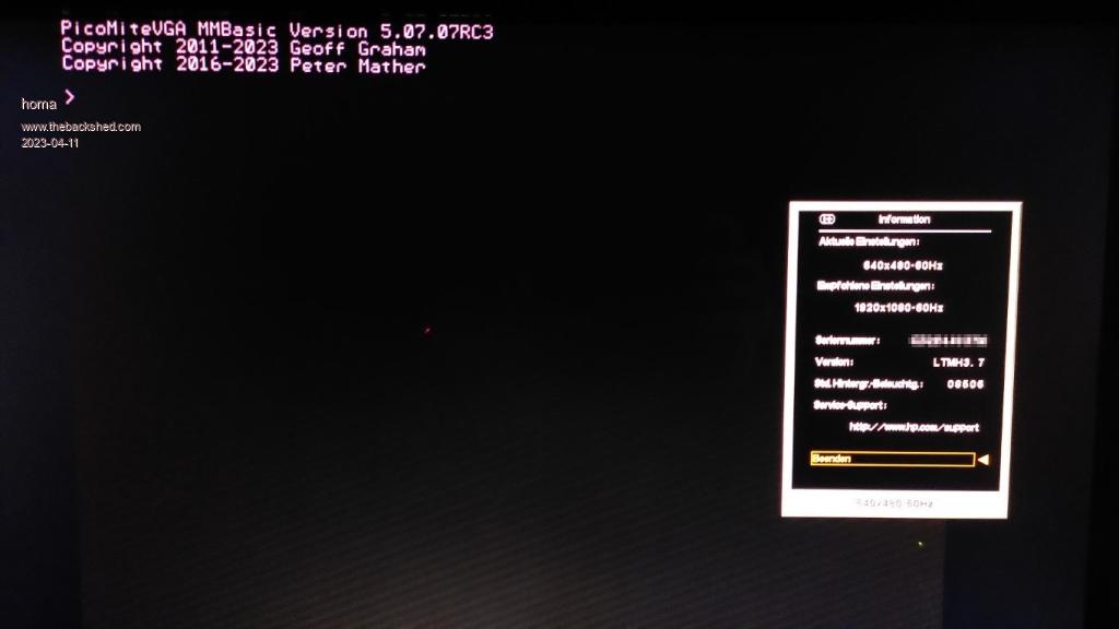

Both. Mode 1 and 2. Or do you mean the resolution on the monitor? See picture ... 640x480-60Hz ![]() Matthias |
