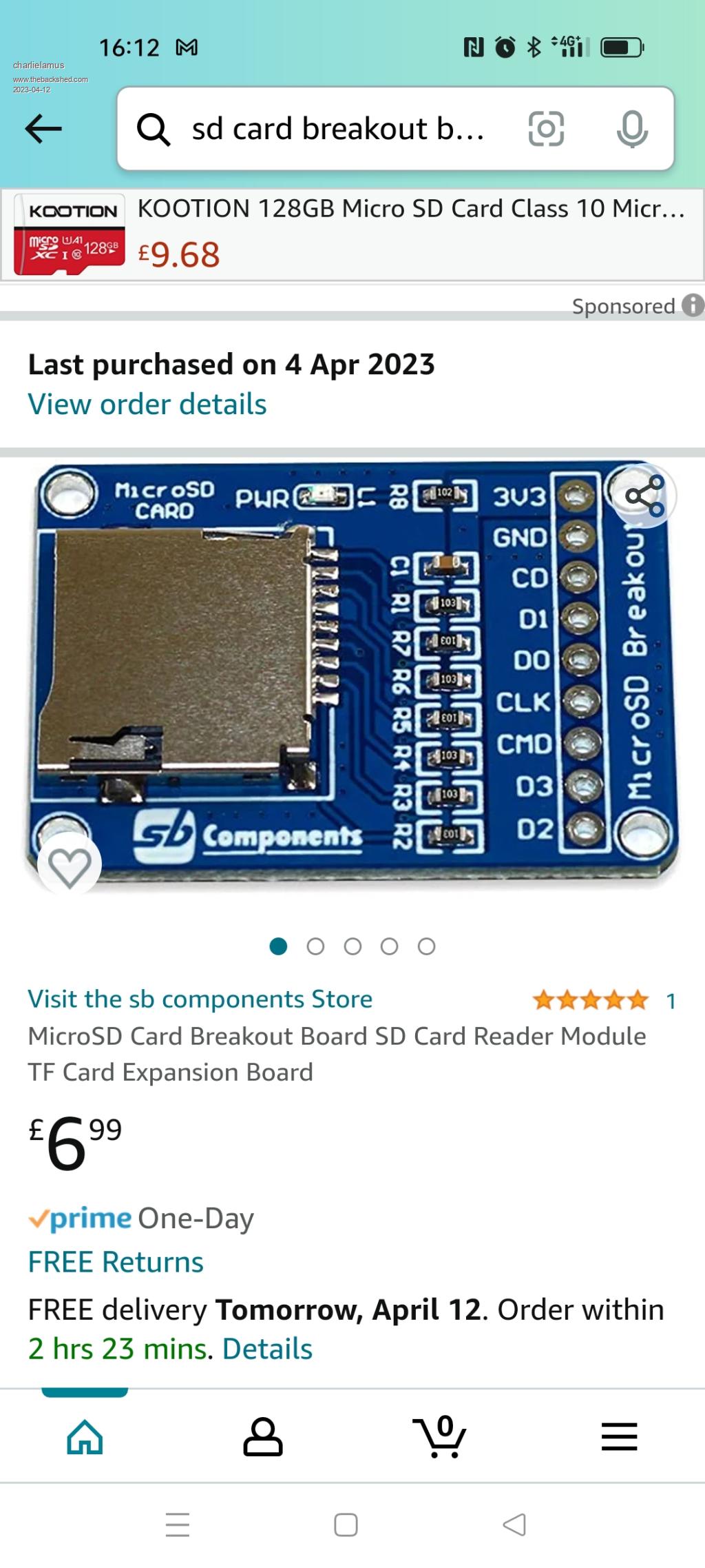

I am having problems connecting my SD card reader - a no-name breakout board from Amazon - to the Picomite.
Once connected, it will happily change to drive B, but on giving the 'files' command it says there is no SD card connected. If I try holding the card in a fraction with my finger, it says that there is no FAT filesystem on it, but does at least say "SD card removed" when I take the card out.
Does the breakout have components on it? There shouldn't be any. Many of them are designed for level changing 5V to 3.3V for Arduino and are not suitable.

Yes indeed it does - a bunch of tiny surface mount components which may be resistors. And the Voltage in pin is labelled 3.3V. is that the wrong thing? I thought that the Pico operated on 3.3v?

This is the one I have:

For simplicity set (assuming VGA firmware)
OPTION SYSTEM SPI GP22, GP10,GP11,GP12
You are then going to connect as follows:
GP10 - CLK
GP11 - CMD
GP12 - DAT0
GP22 - D3
GND - GND
3.3 - 3.3
But first buzz out which resistors connect to these pins and whether they are series resistors or pullups. If pullups remove them. If series resistors remove and replace with a solder blob. They look like pullups so R1-R7 can all be removed. Pullups are used for SDIO connection (and for this they are even the wrong value). They should not be used for SPI connections

I can quite happily identify which resistor bells to which pin but what is the difference between series resistors and pull ups, and how can I tell? I thought pull up resistors *were* in series with the pins?

PullUp has one Side is connectet to +3.3V andt the other side to the Data Pin...
If they are Serial they connect the Data Connection from the Board  with the Data Connection on the Card Reader, so they are inside the data line.

pullups - one end connected to 3.3V
series - one end to the edge connector, the other to the socket

It looks to me as if it should work, in theory. Those resistors look like 10k pullups. Additionally there's a supply bypass capacitor and a 1k/LED across the supply.
As a matter of interest, the micro SD card modules that I got from ebal also have 10k pullups - and they work. Maybe I'm just lucky?
I assume you are using the 3V3 supply from the PicoMite?. You could try adding a 2R2 series resistor then an electrolytic bypass capacitor of 10-47uF. Normally we don't need to filter the supply for micro SD cards.

It looks like this card is designed to work with 3.3V micros and the Raspberry Pi Pico in particular.
See this reference: https://learn.sb-components.co.uk/MicroSD-Breakout
So the problem is not with the breakout card.
It would be best to do as Peter suggested...
