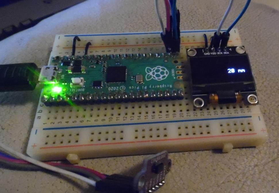

help me please. I want ssd1306 on i2c2 and other device on i2c. not a clue how to.
display works on i2c and device works on i2c with spi display but want i2c ssd1306 and i2c device to send data to ssd1306.
option reset
> setpin gp18,gp19,i2c
Error : Invalid configuration
> setpin gp18,gp19,i2c2
> OPTION LCDPANEL SSD1306I2C2, L
Error : Invalid display type
> OPTION LCDPANEL SSD1306 I2C2, L
> OPTION LCDPANEL SSD1306I2C, L
Error : SYSTEM I2C not configured
> SetPin gp4,gp5,i2c
> SetPin gp4,gp5,i2c

Posts: 8911
Posted: 08:33pm 12 Apr 2023
OPTION I2C GP18, GP19
OPTION LCDPLANEL SSD1306I2C, L
Note: you can't use a dual mode SPI display on I2C unless you modify it (according to the instructions) first. You don't specify whether it's I2C or I2C2 as that's taken care of in the OPTION I2C command. In this particular case it's I2C2 as that's what the pins connect to.
You can use other stuff on the same I2C as long as they are on different addresses. You don't need to OPEN I2C2 here because it's already been opened. Neither do you need SETPIN.
If you want to use the other I2C channel you will have to do everything from scratch as it can't be system I2C.

Posts: 3290
Posted: 10:44pm 12 Apr 2023
As Mick says connect the module to the same I2C pins as the display. Use just the same OPTIONS you normally use to setup the display then your Sub getdistance should work.
As each has it's own address and do not "talk" at the same time there should be no need for I2C2 or any of it's settings.

Posts: 3290
Posted: 12:02am 13 Apr 2023
Yes, it is similar to SPI except instead of using CS pins to choose which device to talk to each has an address.
The display driver knows the address of the display and opens I2C. Your Sub uses "i2caddr" for the distance module.
Each device only responds to commands with its address and simply ignores commands with any other address.

Posts: 8911
Posted: 04:31pm 13 Apr 2023
Don't use SETPIN.
Do what I said in my first reply.
You need to put the correct pins in OPTION SYSTEM I2C, obviously, the ones connected to your display. A display has to be on SYSTEM I2C or it won't be seen by MMBasic as a display.

Posts: 11512
Posted: 06:32pm 13 Apr 2023
OPTION SYSTEM I2C GP18, GP19

Posts: 2807
Posted: 09:01pm 13 Apr 2023
Thanks so much for helping me. option system i2c was needed. I had ssd1306 working... how I forgot... losing the thread :0)
The range finder and ssd1306 on same pins.
I2C is clearer now like spi display, touch and sd card share pins
but i2c uses addresses. You guys are stars, ta for help.
